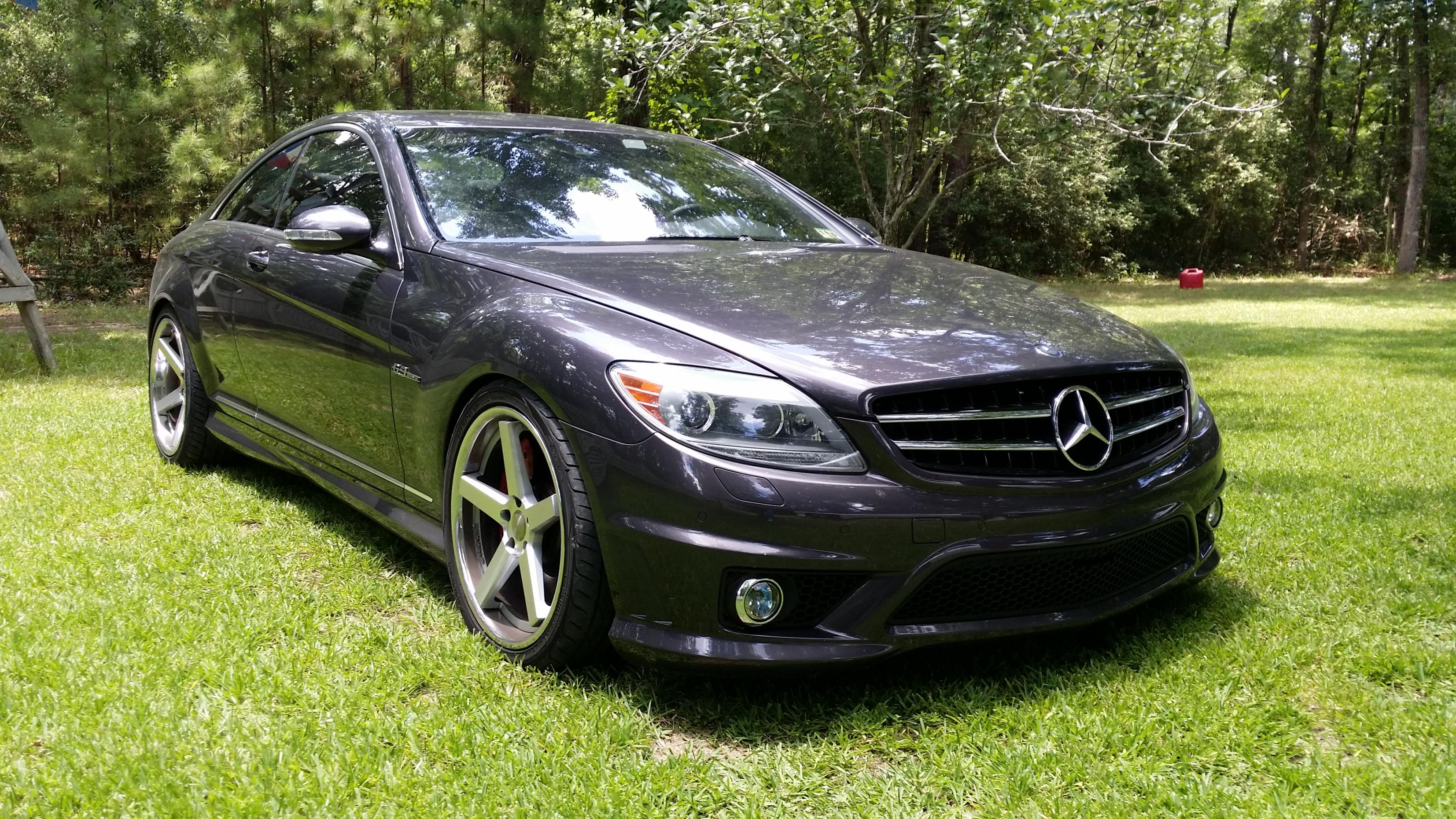

OK, been doing a lot of searching, but coming up empty. What are the stock wheel sizes and offsets for 2008 AMG CL63? Bought my car with aftermarket wheels and may be changing to something else. Current wheels are Stance 20's with 255/35/20 and 275/35/20 tires, and noticed the fronts have spacers installed. Just trying to what the stock specs were and what the current specs are, then I can go from there. Thanks,
Here is a pic, don't know if that helps any:

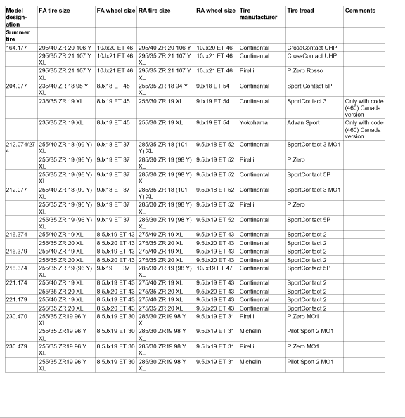

This may help:

Thank you, just what I was looking for
