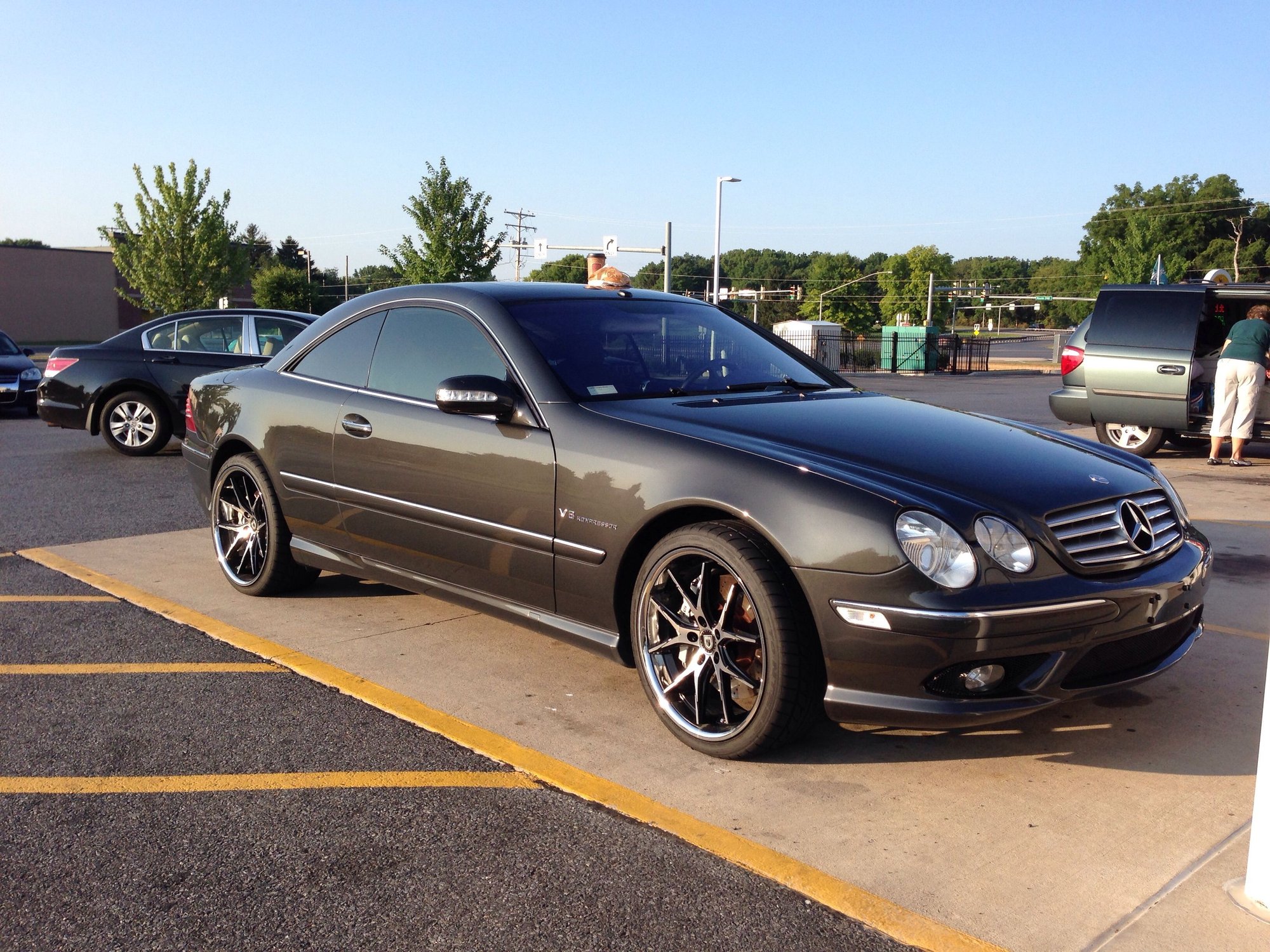

All,
I am looking at lowering links vs. lowering module. But don't want the dreaded ABC nightmares.
How long have you had lowering links on your 215s without any Suspension issues please.
Regards,
Double-A
