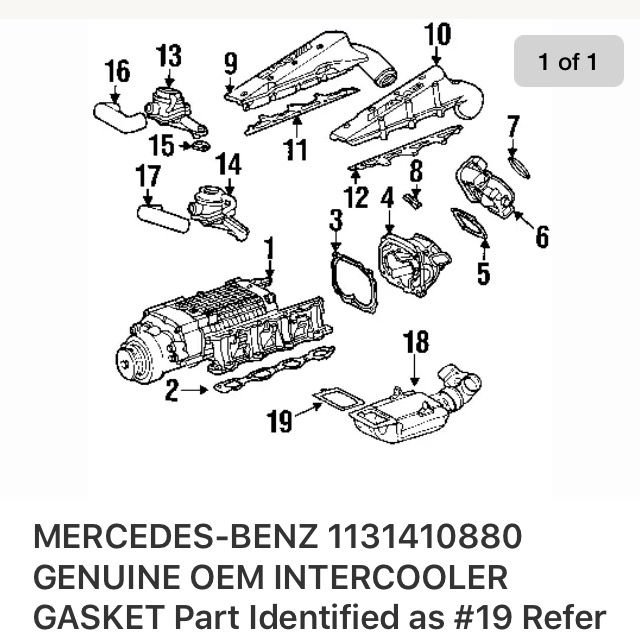

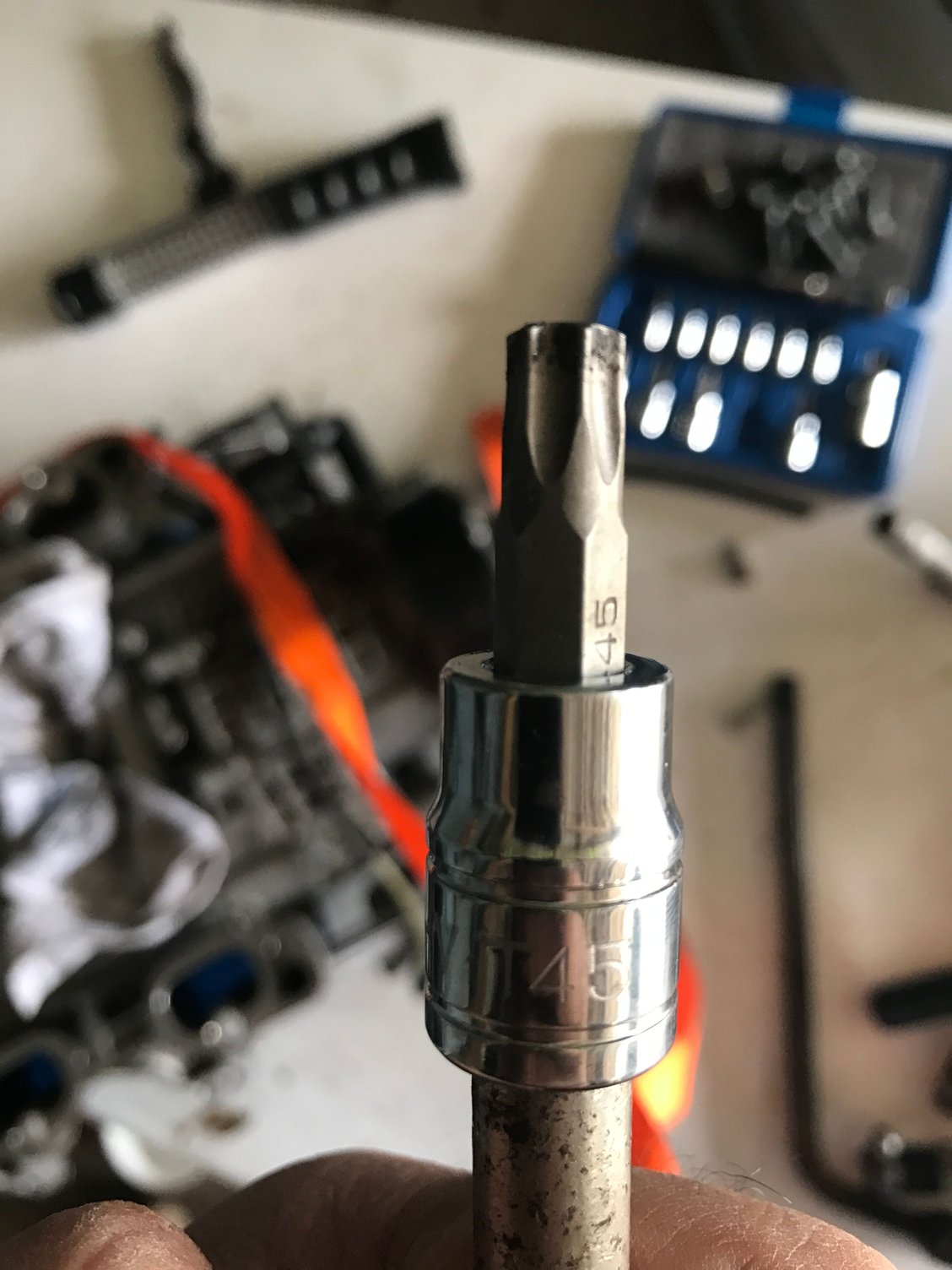

some parts that i ordered:
T45 needed for 8 screews to separate sc from the engine and 6 more to get the intercooler off the sc.

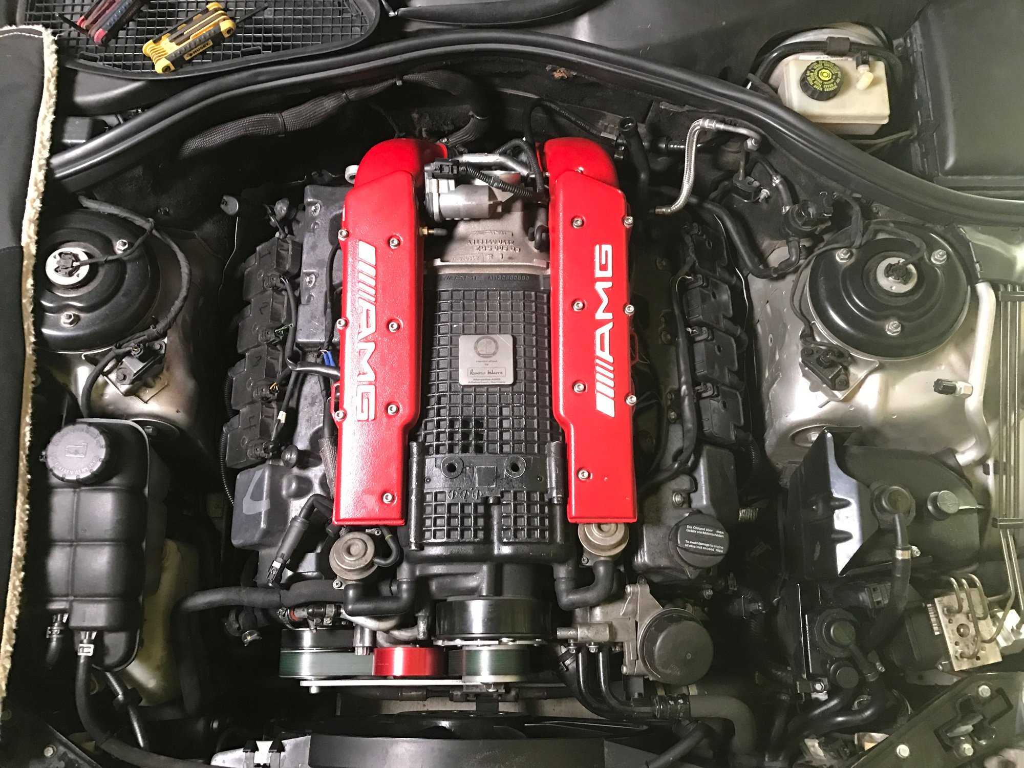

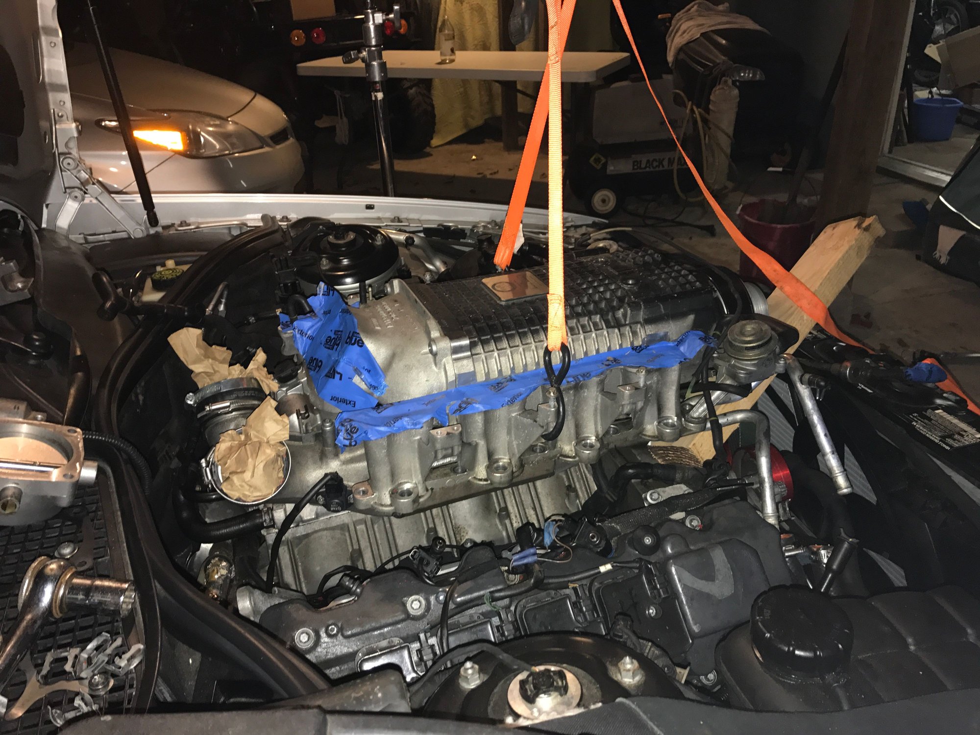

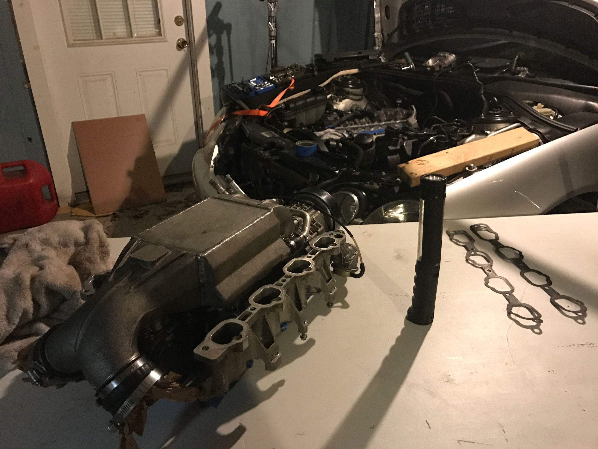

and i started the work today, so far so good,
i am taking tons of pics to make sure i know how to get everything back together.
after separating the ic from the sc i saw that the sc was filled with water, that can't be good...:crazy
if you do this procedure use new screws from the dealer and torque them down with the right Torque!
