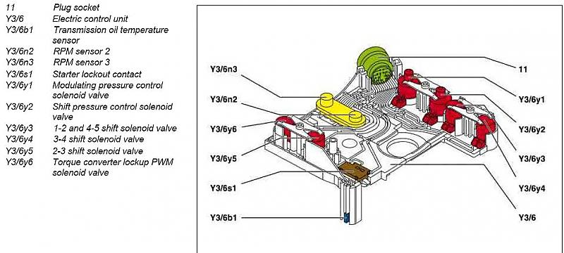

ok, had it scanned on STAR and its come back with the following:-
P2222 - The signal of component Y3/6b1 (Transmission Oil Temperature Sensor) and/or Y3/6S1 (Starter Lockout Contact) is implausible.
2004 S55 Transmission issue - changing gears at 4k revs?-mercedes-20transmission-20valve-20body_zpsn5gu2iot.jpg
So its either the Transmission Oil Temperature Sensor OR the Starter Lockout Contact which are faulty, or worse still, Both are faulty.
Would this point to a part that can easily be replaced or would this point to an expensive Valve Body?
The other thing iv noticed is that it mainly only gets stuck in 1st gear, and mainly only when it comes up to temperature. Possibly pointing towards the Oil Temp Sensor?
Its the 2 components on the left side towards the bottom. The signal seems to have been lost between the 2. Like i said, im not sure wether either of these bits can be replaced individually or wether the whole Valve Body needs to be replaced. ORRRR, wether the valve body can be rebuilt?
