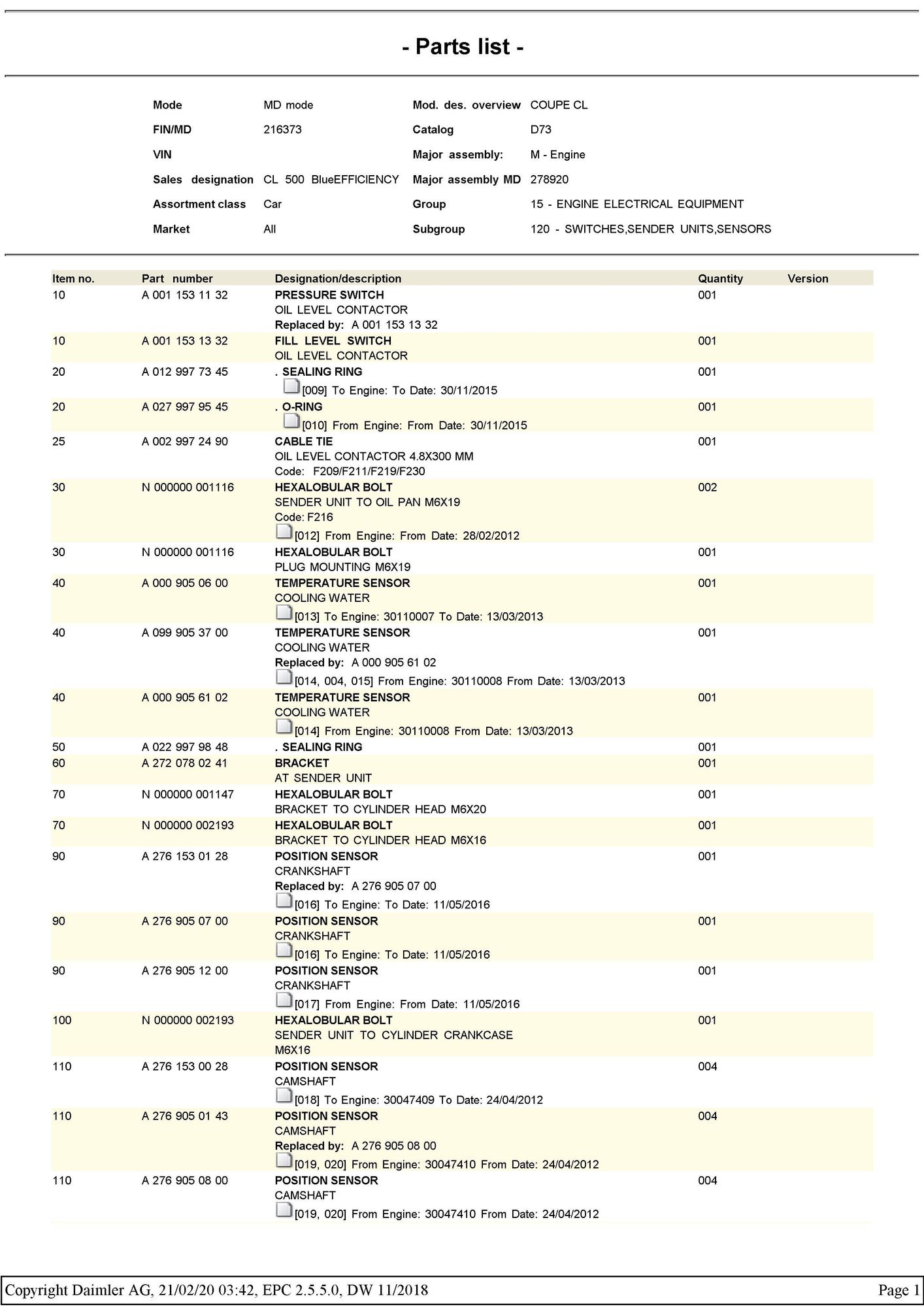

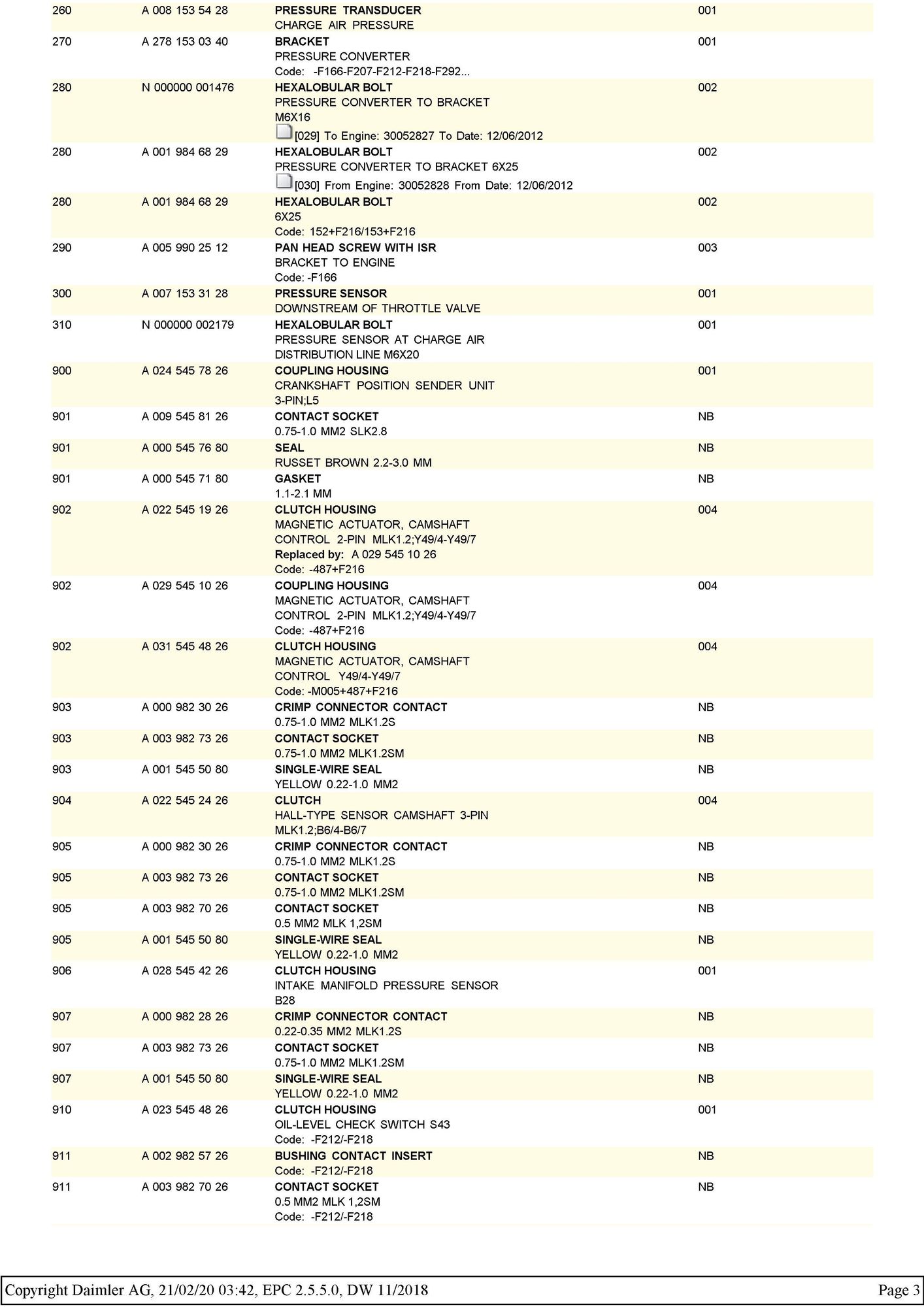

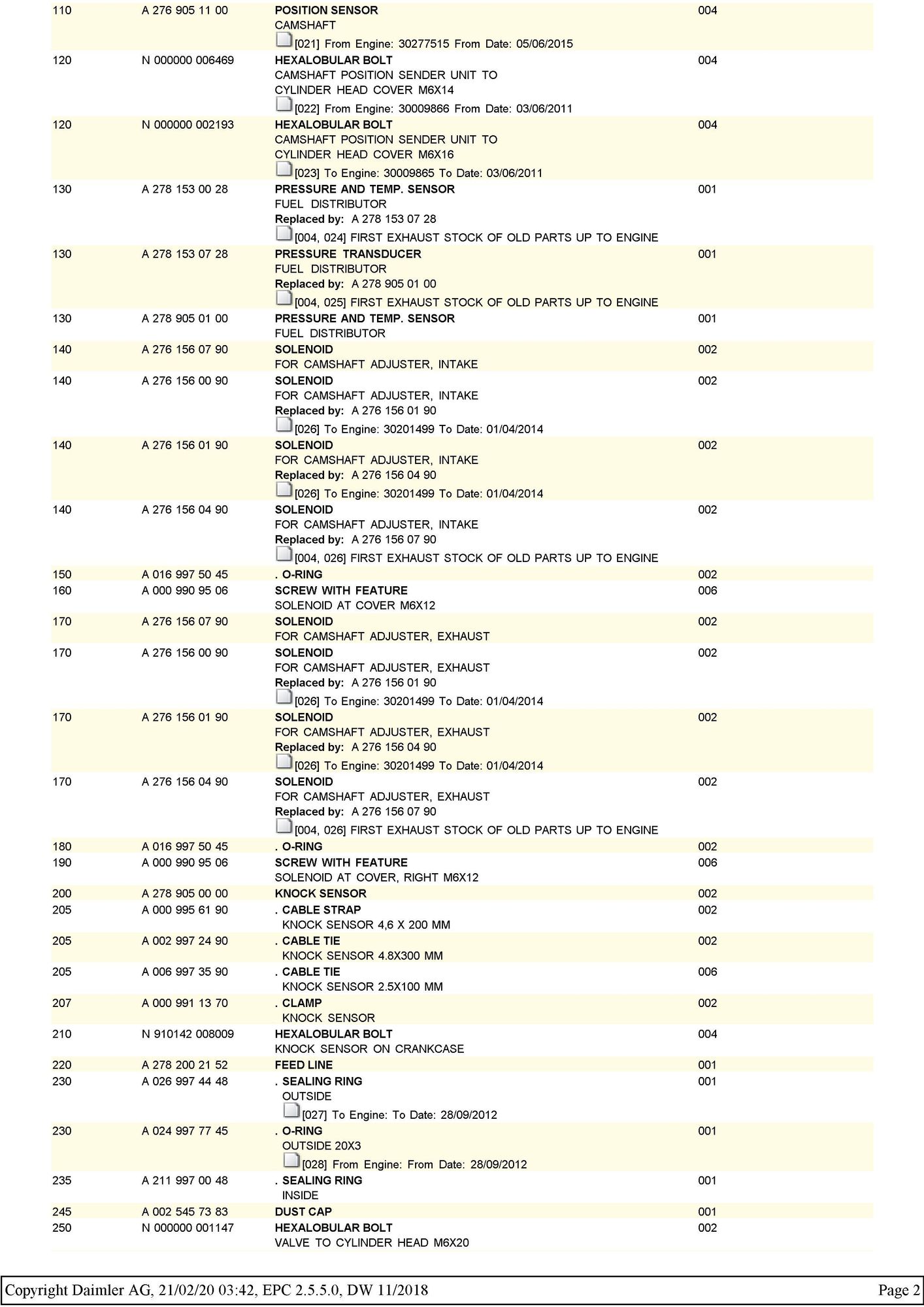

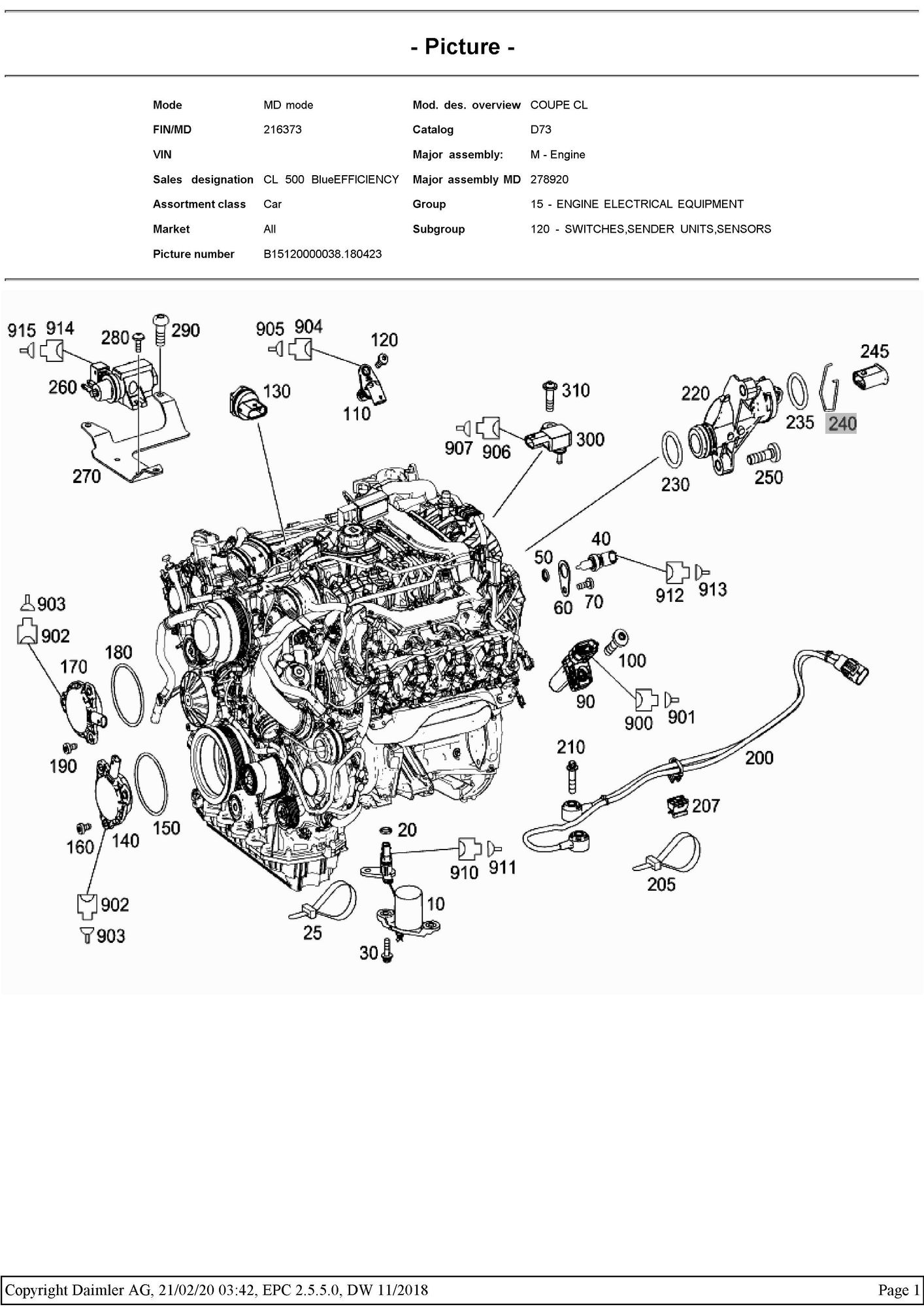

Hi all,
I was just driving home today and got an EML light. OBD scanner has thrown up P0015 "camshaft position - timing over retarded" (Bank 1).
I had no noticeable rough idle or noticeable driving defects so thought I'd clear the fault and see if it was a result of a sensor due to cold weather. After clearing its come straight back along with P0060 "heated oxygen sensor (HO2S) Bank 2 sensor 2 heater resistance "
As camshaft sensors are pretty cheap ~£30 I was thinking of just changing it before I start going into Star diag etc.
Is this wise? And can anyone help me locate the cam sensor on my engine?
W216 2007 CL500 5.5L
Many thanks
​​​​​​Dave
