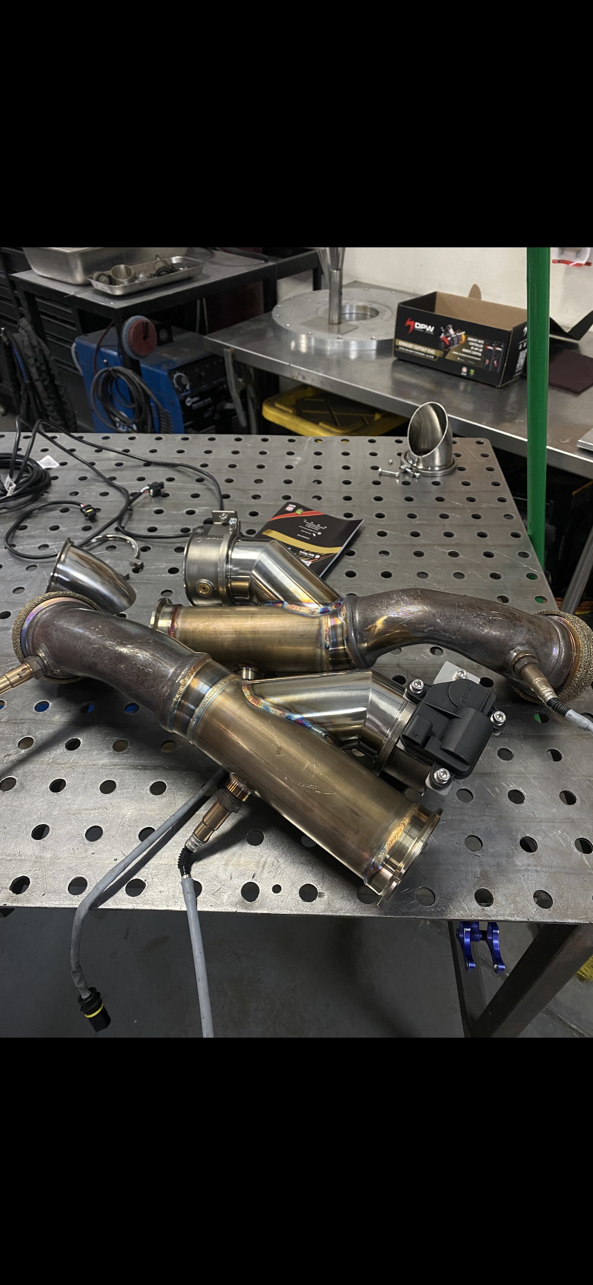

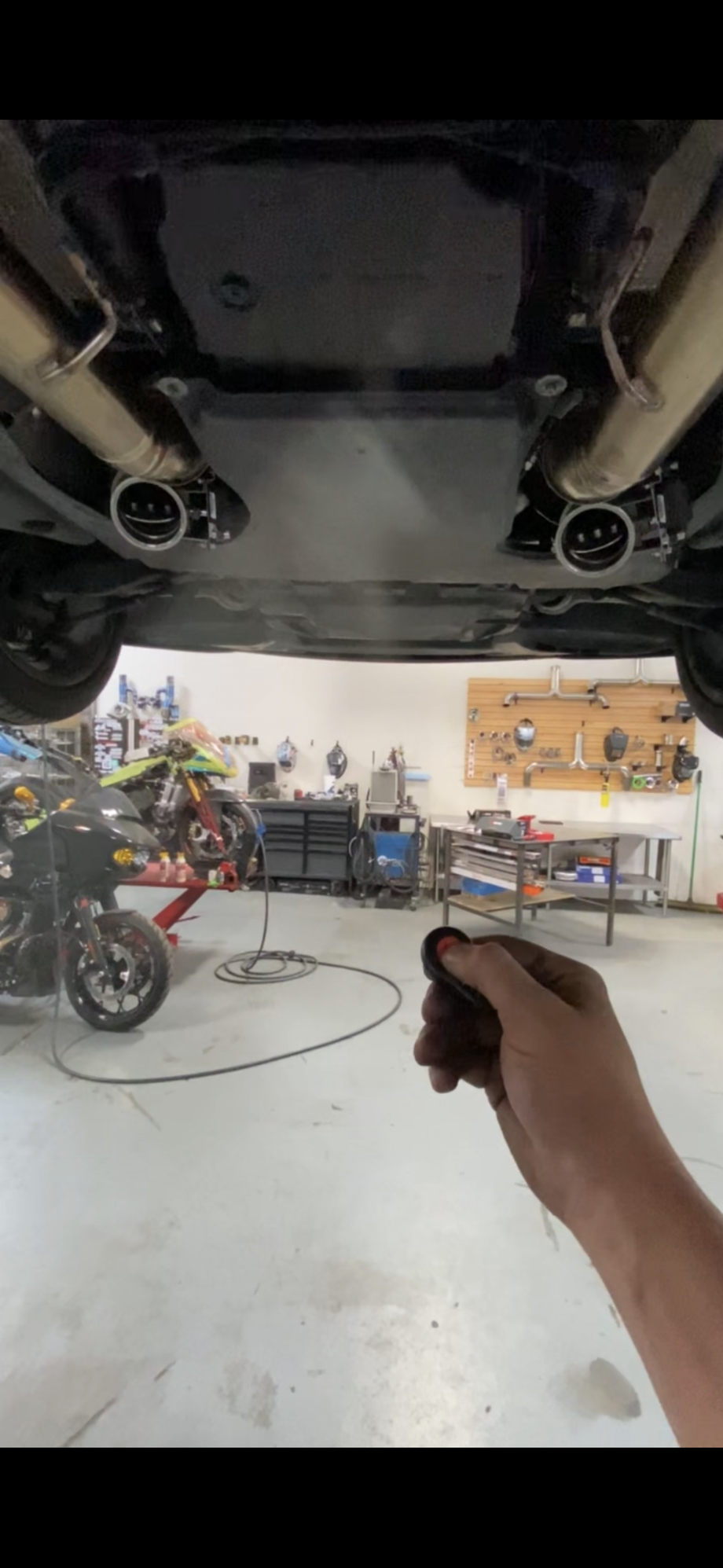

Yoo. After some hard work we installed some dpw 3” cutout’s right about where the cats were located. I’ll post any gains on Wednesday. I run very consistent 11.8’s@117-118mph at Bandimere speedway……typically 8,800 DA (solid .7 -1 second slower than sea level tracks) . My mods are Eurocharged race tune, TCU tune, Hoosier 245/40/18 drag radials, 3” dp’s.
Im really hoping I pick up some mph and get my et’s into the 11.5 territory (my best 60’ is 1.74 so if I can drop that to a high 1.5 I’ll be there) all my other turbo cars had solid gains from adding cutout’s so I’ll let everyone know how it goes.

Nice work, looks fantastic. Hope it produces some good results for you.

It must make that magic force fed bent-12 noise now.
