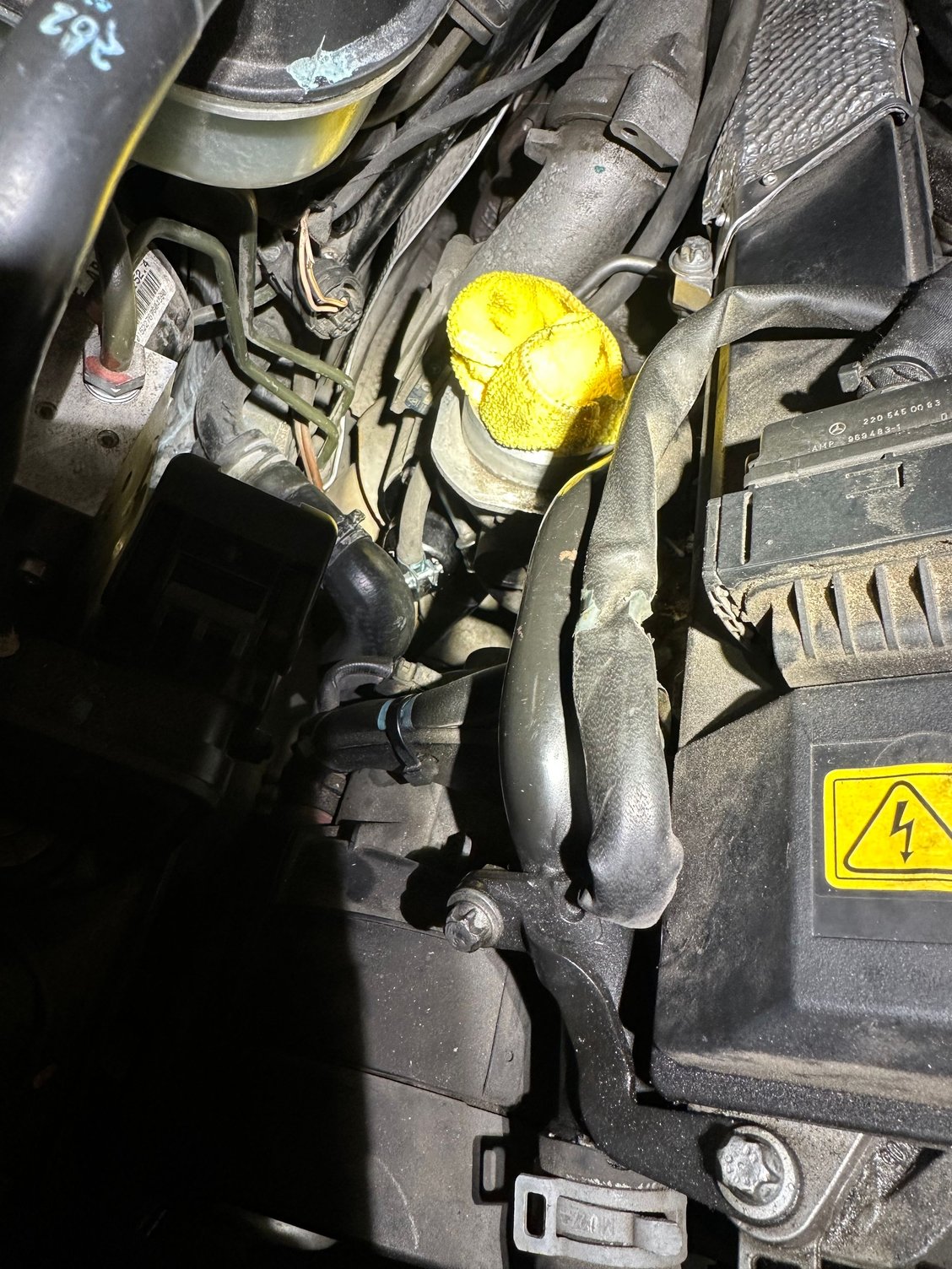

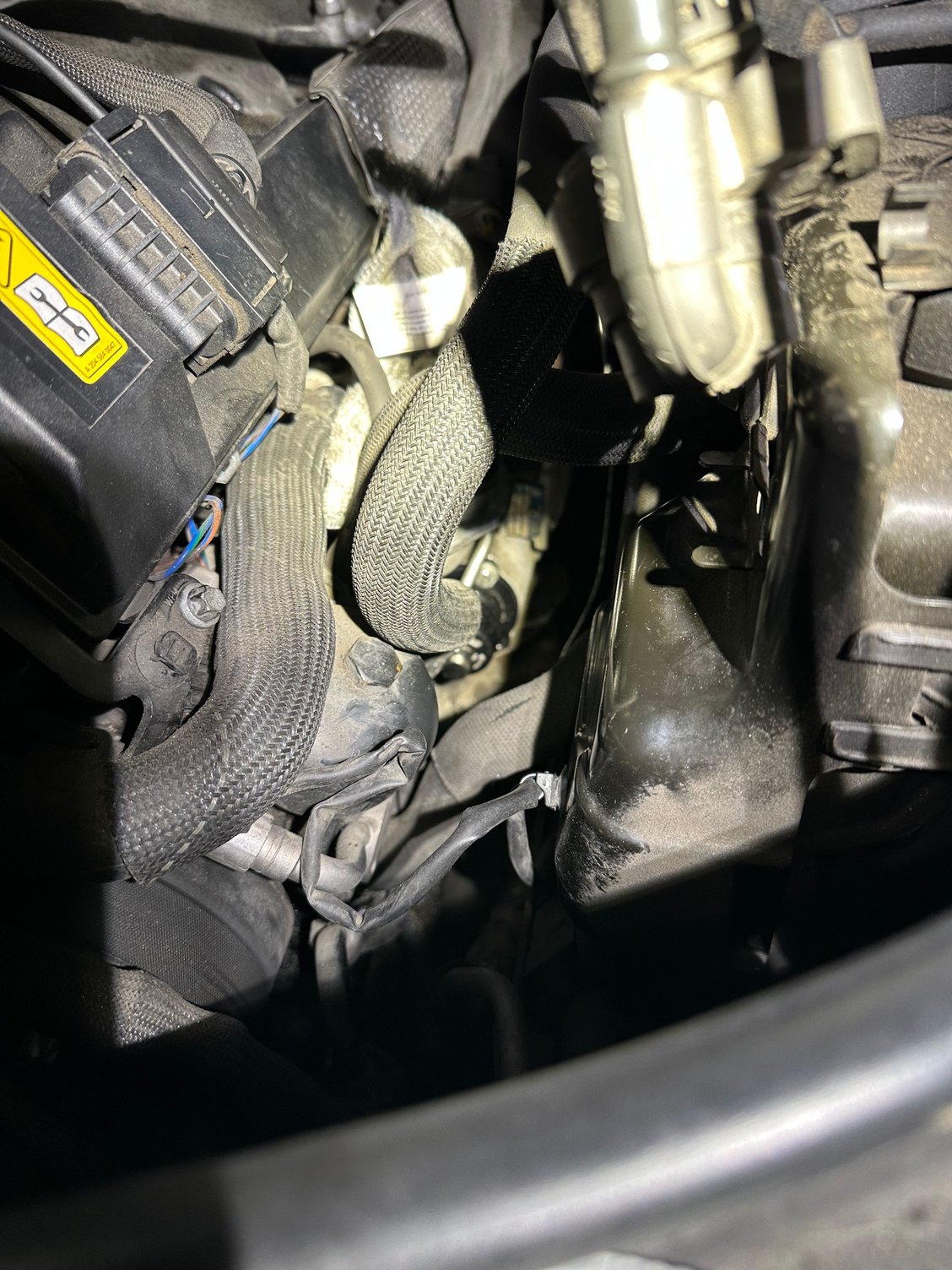

Loosen both motor mounts and jacked the engine up then pulled it to the passenger side to give me just enough room for driver side
Driver side
Driver side
 Pass side
Pass side
