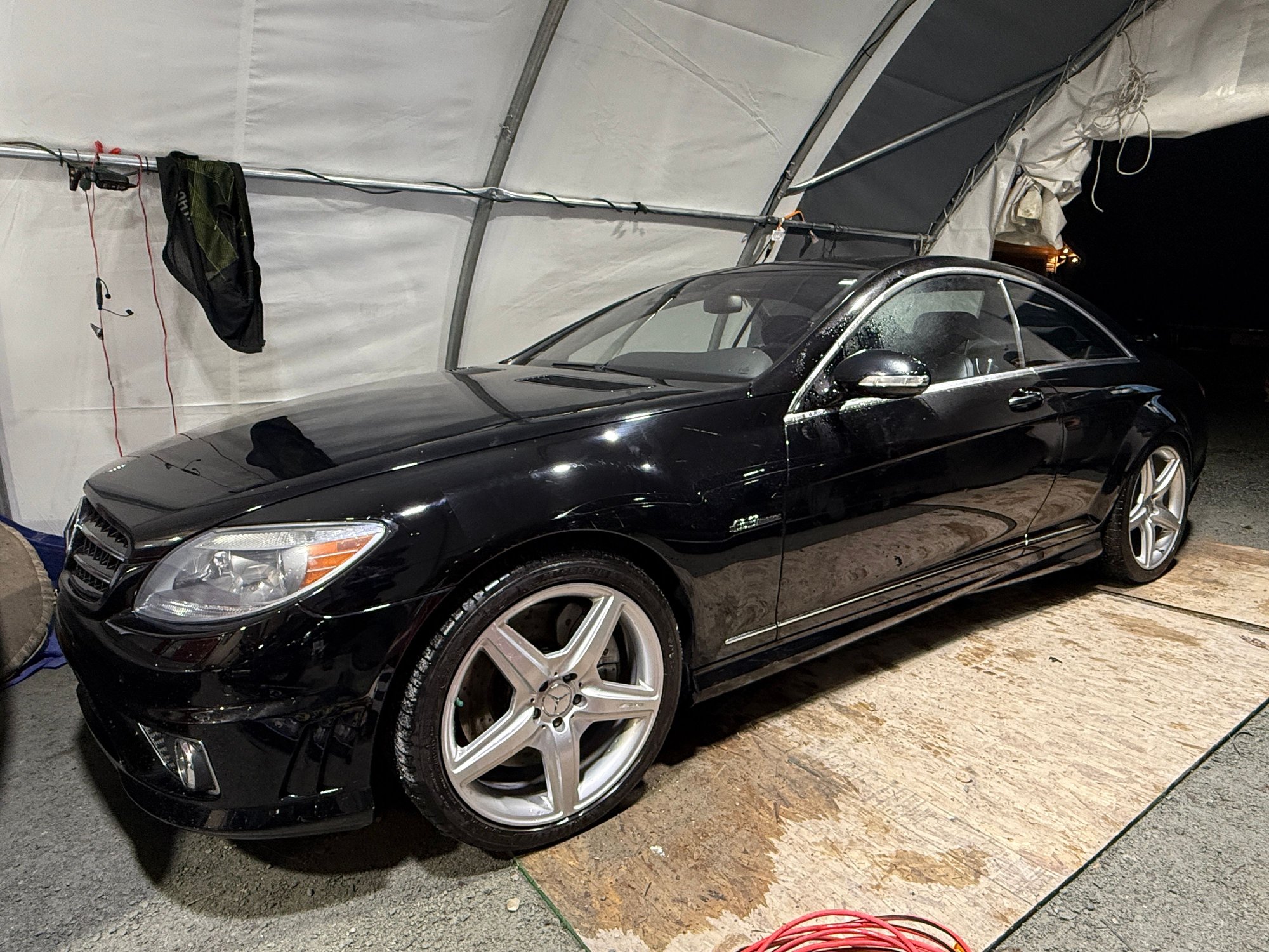

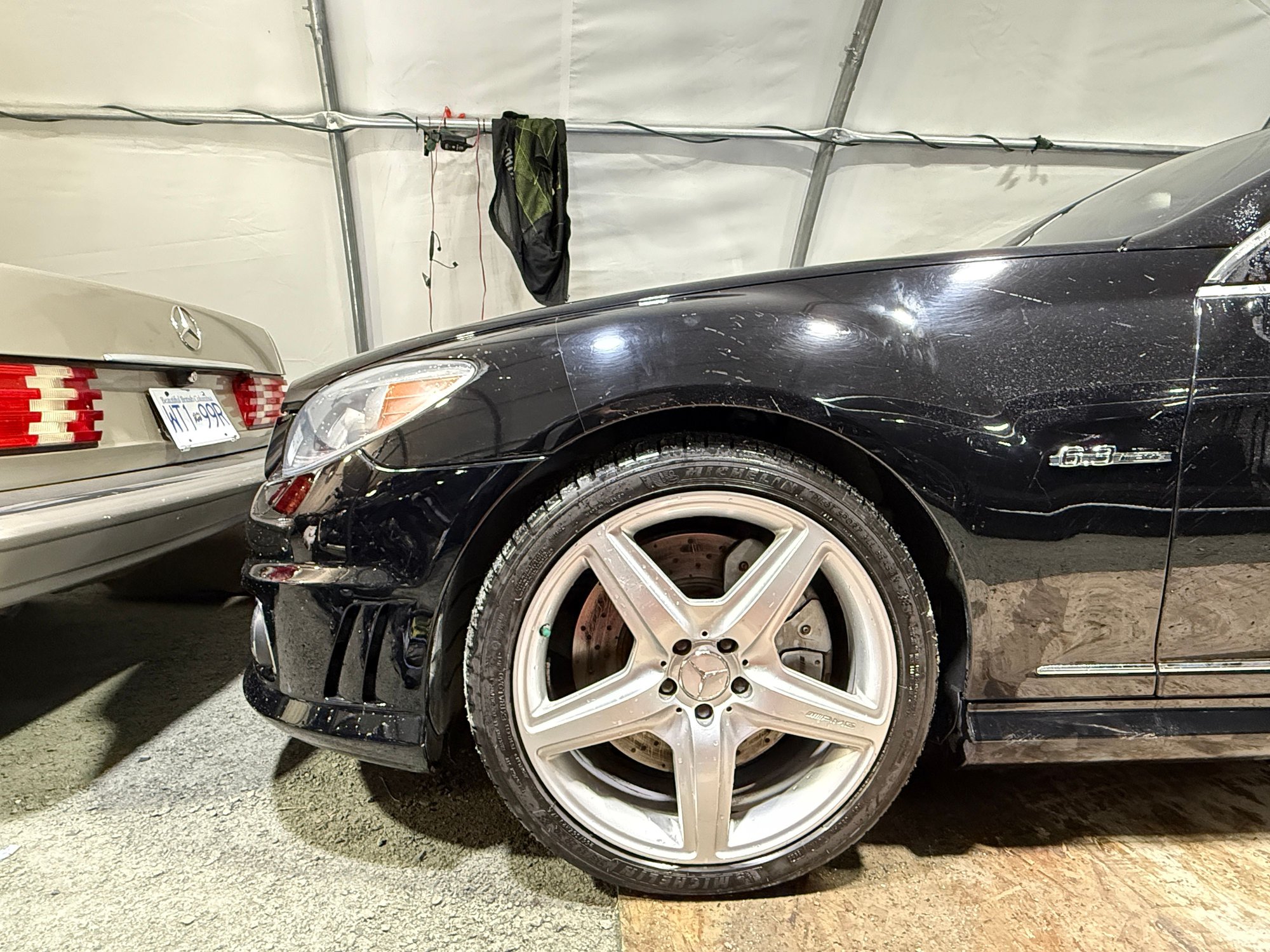

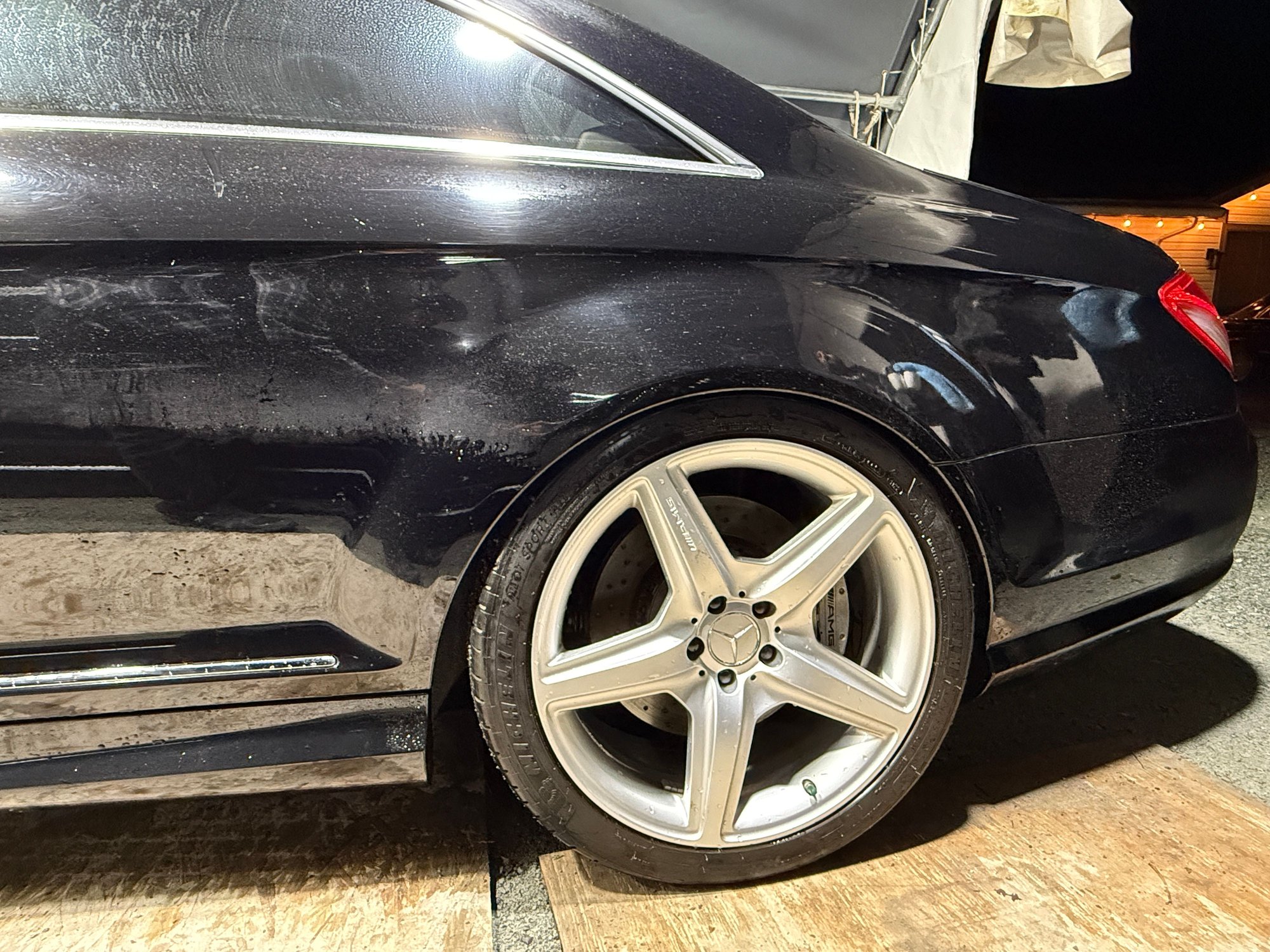

Hi all, all day today I spent trying to lower my 2008 CL63 with lowering links. The ABC system was functioning perfectly beforehand it would raise when I click the button. I would also say I am not a noob at this and know what I am doing…I guess not. I’ve done this same exact thing on my 2021 E63S, but this didn’t go to plan. I’ll break down what I did, I hope someone’s had this issue and or knows how to fix this.
**if this matters, when I started the job I had the ABC in the “highest mode” the button was clicked
Two links in the rear (very long)
Two shorter links in the front (in-front of the control arms)
rear links I made SHORTER than the factory rears.
front links I made LONGER than the factory fronts.
JOB COMPLETE…or I thought so.
right when I dropped the car down, the rear looked amazing, exactly where I wanted it.
But front doesn’t seem to be affected??
I tried to extend the links as long as possible, almost 1” longer than factory front links but still no change.
But ALSO. When I now click the ABC raise button to raise the suspension, only the front raises a tiny bit…(it also sometimes randomly goes lower WHEN I CLICK THE RAISE BUTTON). I have no clue what it going on.
I cannot drive the car yet because it has no insurance, but what the hell.
Any help? Do you suggest driving the car? Only valid reason I have is that when I dropped the car down and turned it on, and I also clicked the lower button (turned off the raise) the car tripped out. Too much was happening? And now the front is just raised, rear is low, but rear doesn’t go up when I click the button.
Any help is appreciated.
