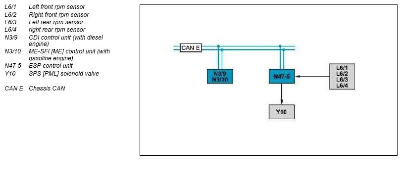

All the diagrams I see in the WIS for that particular year indicate your culprit might be the ESP control unit (N47-5), which receives vehicle speed from the 4 wheel speed sensors and outputs a speed signal to a bunch of other systems such as power steering:
Sounds dumb, but did you try recycling the ESP switch while driving to see if it clears anything?
