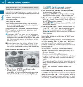

There are 3 modes
Sport is one option, but traction control is still on, just provides more latitude. Pressing ESP briefly once, puts it in sport mode. If you continue to hold the ESP button it will turn traction control completely off.
Attached Thumbnails CLA/GLA 45 traction control-esp.png

Thanks, have you confirmed this on your CLA45? I would assume it would be the exact same on my future GLA45

It was the same on the A45, as the CLA45, so safe to assume on GLA45.
Enabled by default, short press for 'Sport' mode, long press for 'Off'.
