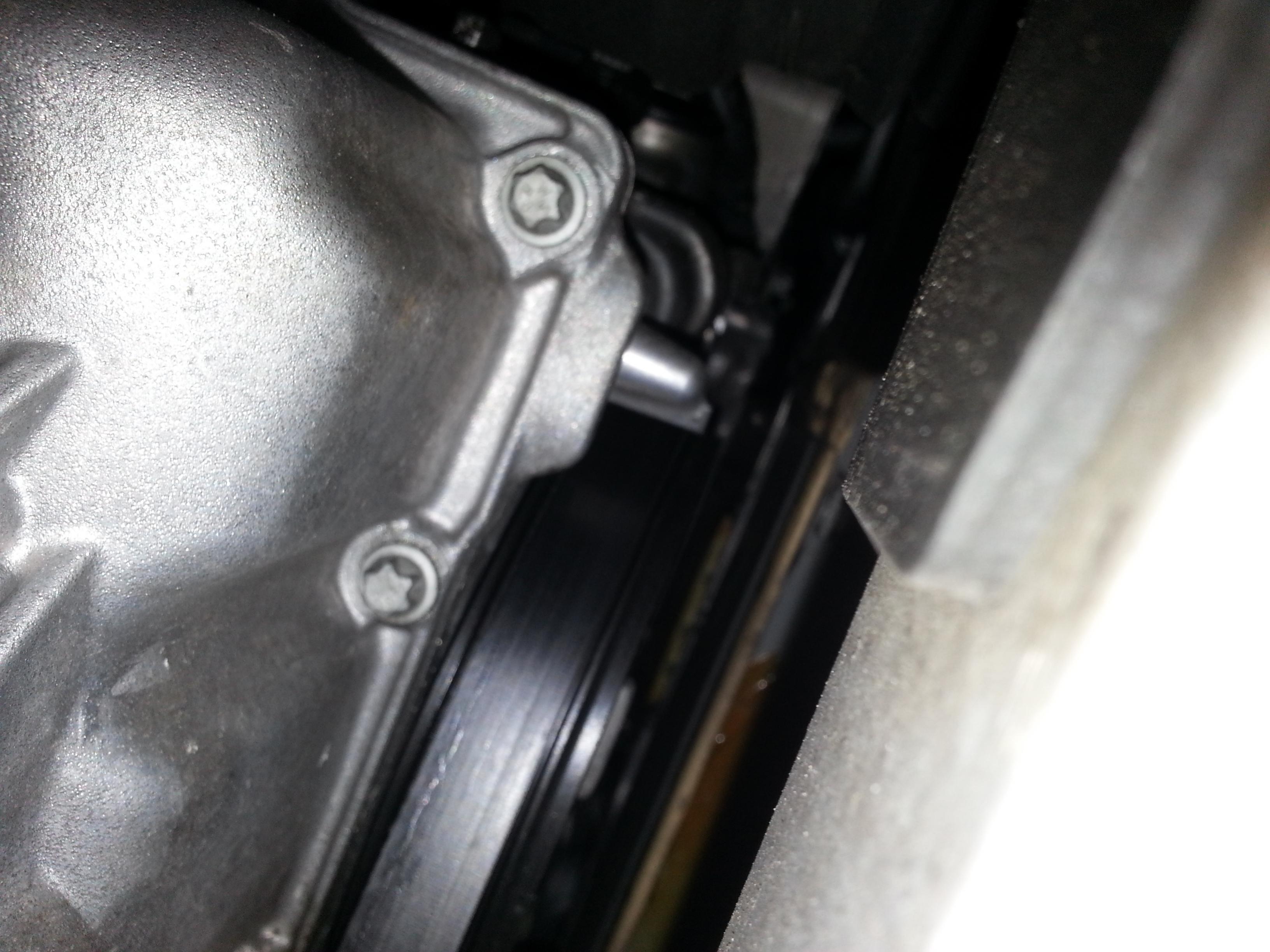

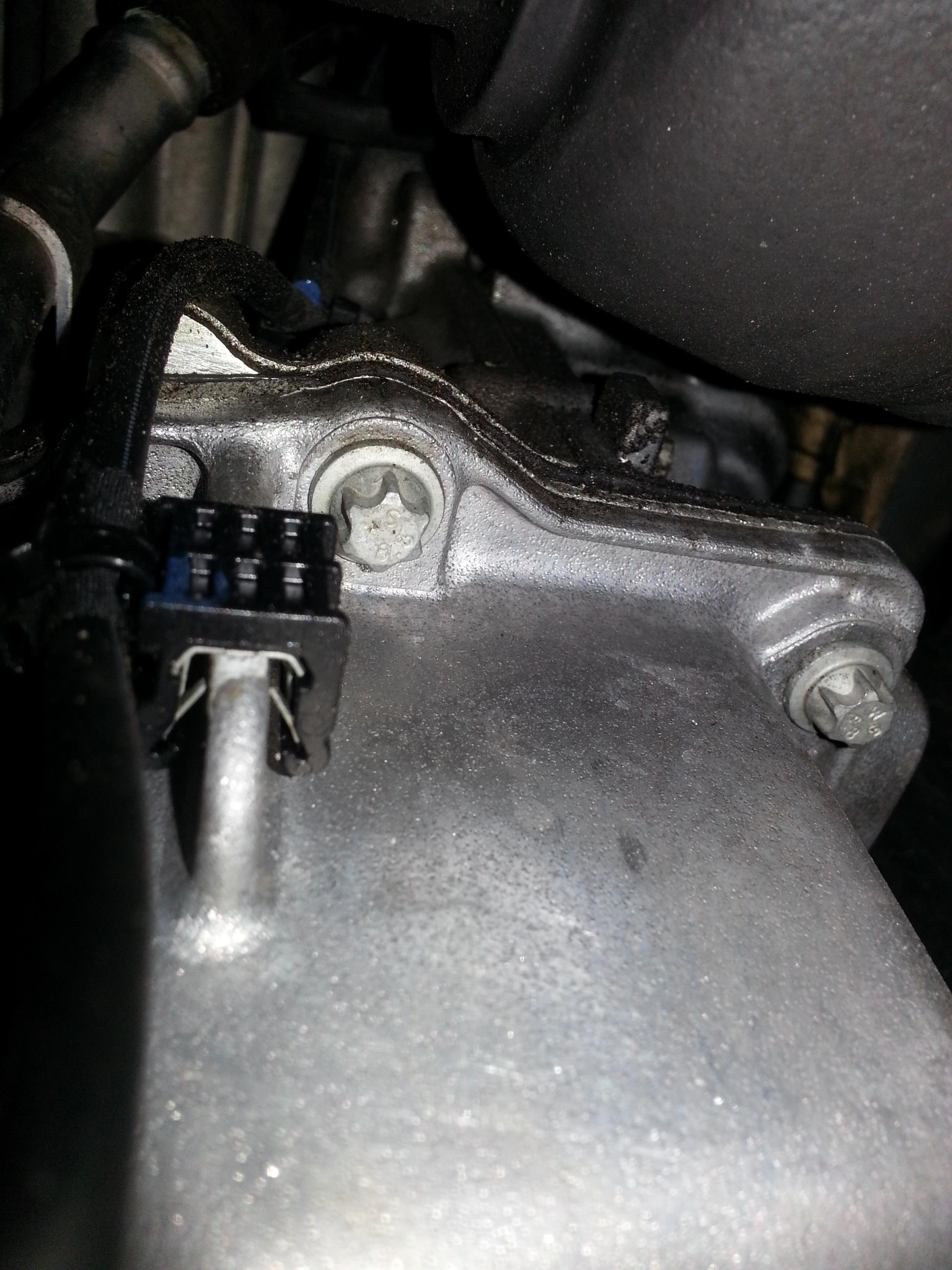

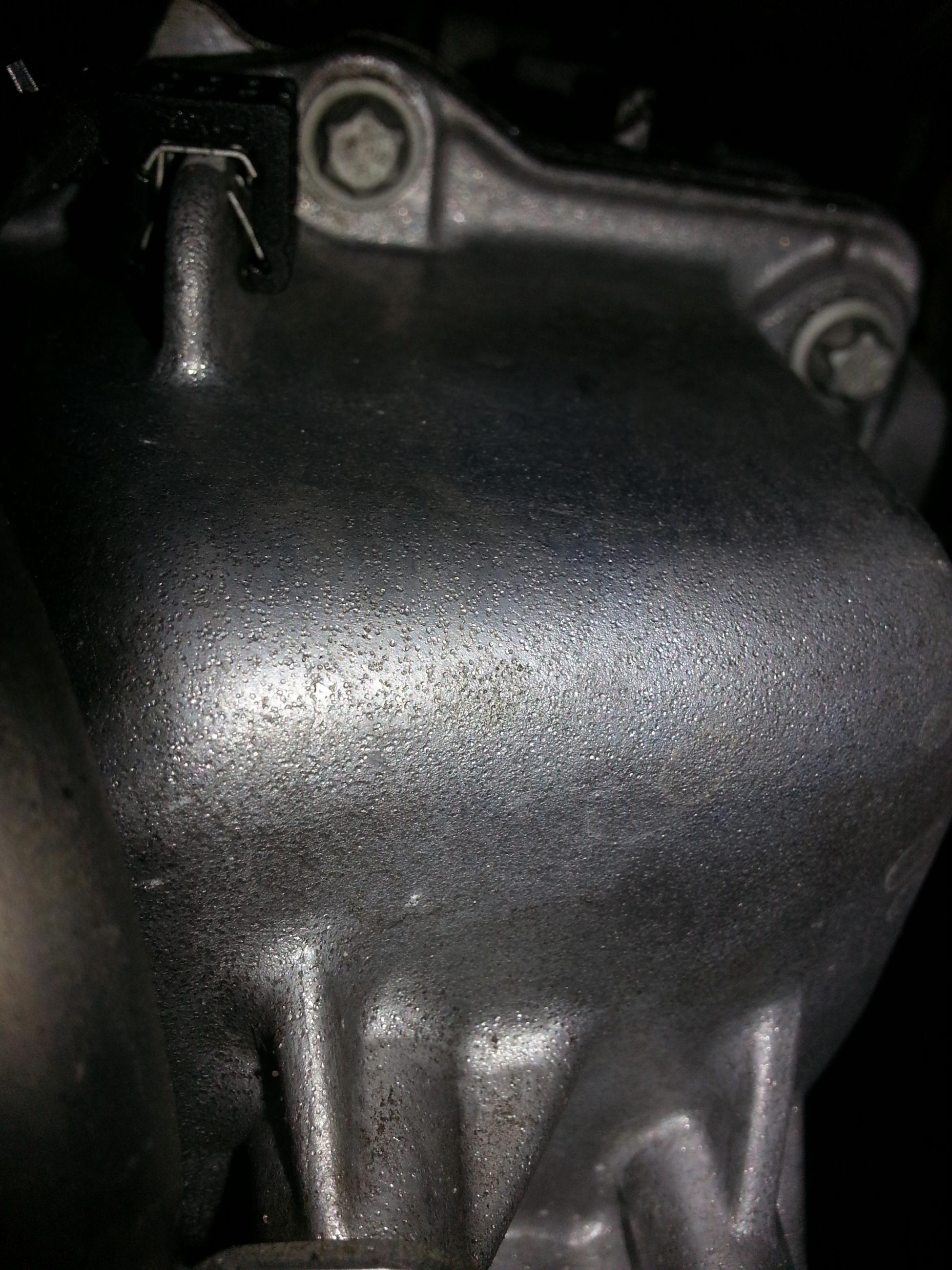

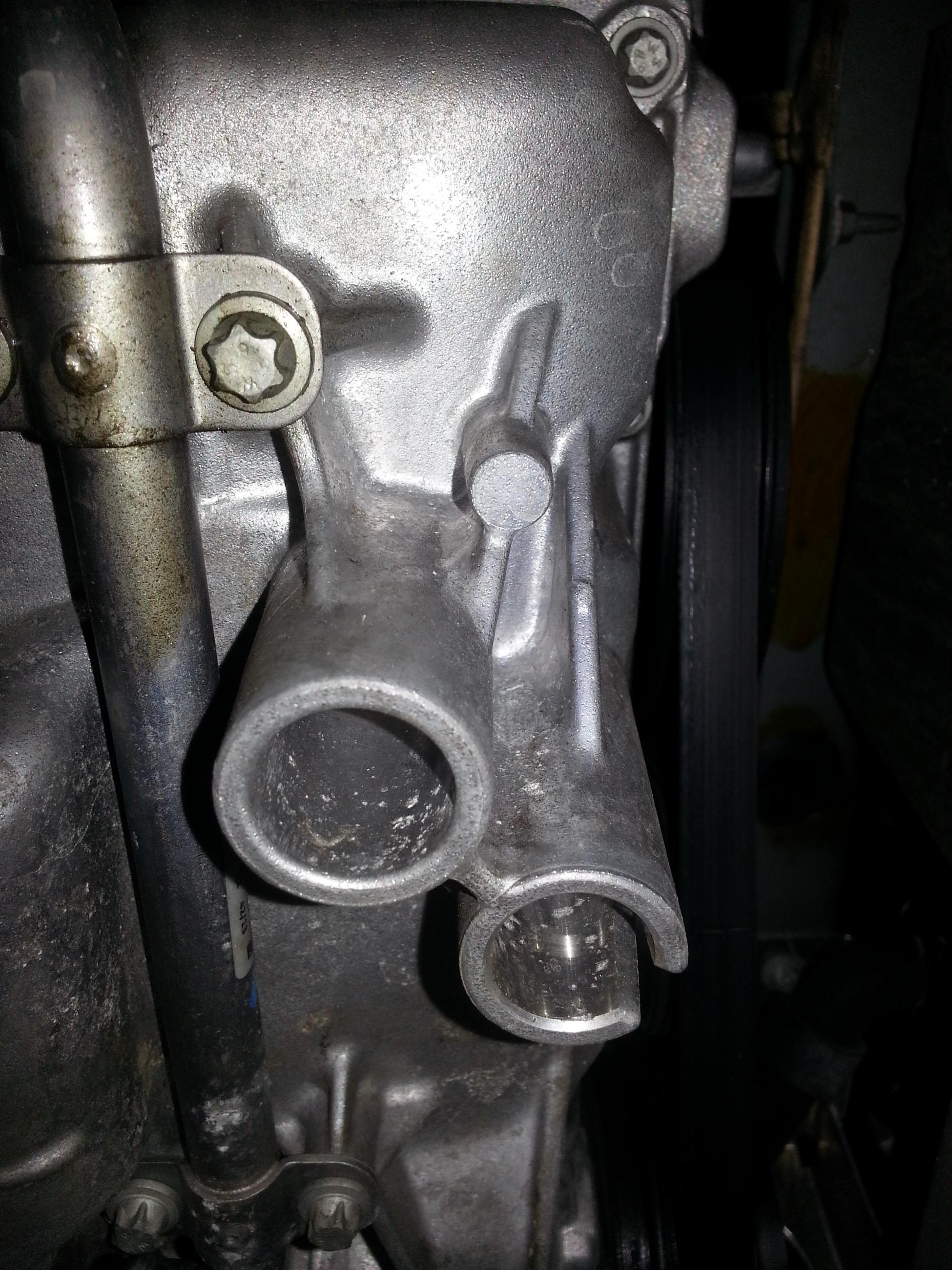

I did a search and didn't find anyone so I thought I would give everyone the heads up.
If you are noticing oil around the bottom of the engine along side the right (passenger side) it is due to the upper front cover.
It needs to be taken off, cleaned and resealed with sealant.

Originally Posted by auzbenz
The photos look good, where are they??
apologies....life got in the way of the internet.
the engine in these pictures was already cleaned off.
basically, the oil drips down around the back and pulley side of the engine in that back corner, if you see oil in that vicinity its from the upper front cover.
