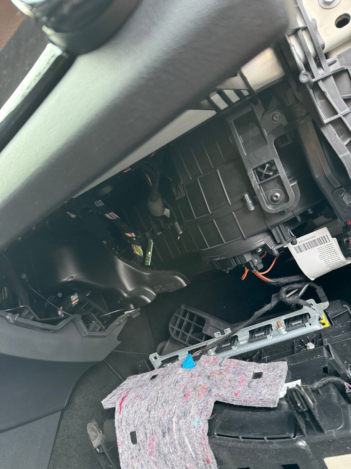

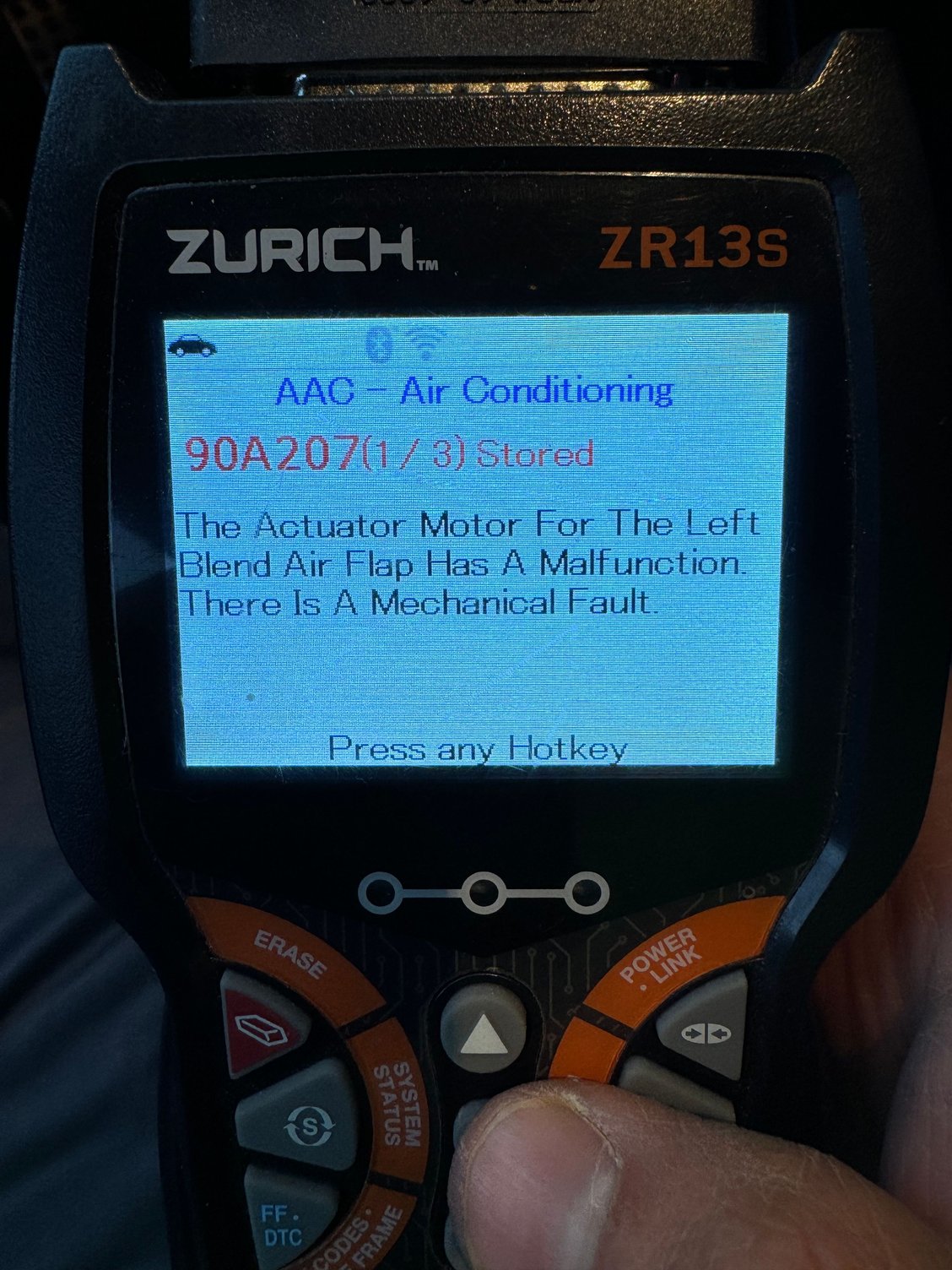

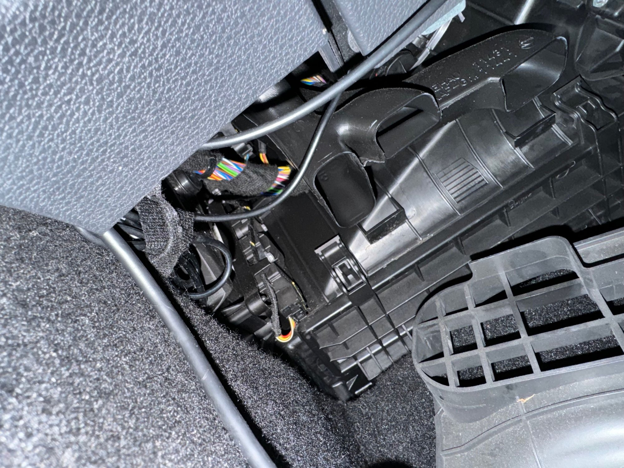

Does anyone have this problem? The heat on the drivers side doesn’t work but it’s fine in the passenger side.There is 3 blend door actuators in the passenger side before touching anything I was getting.
“The Actuator Motor For The Left Blend Air Flap Has A Malfunction.There Is A Mechanical Fault.”

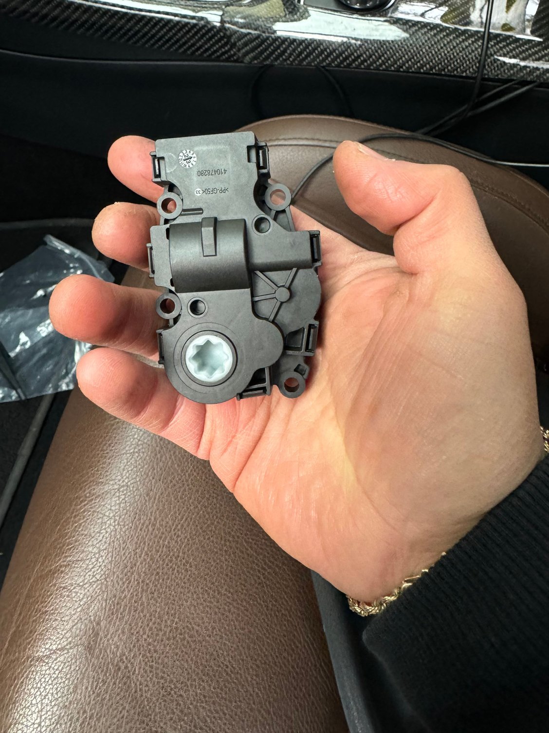

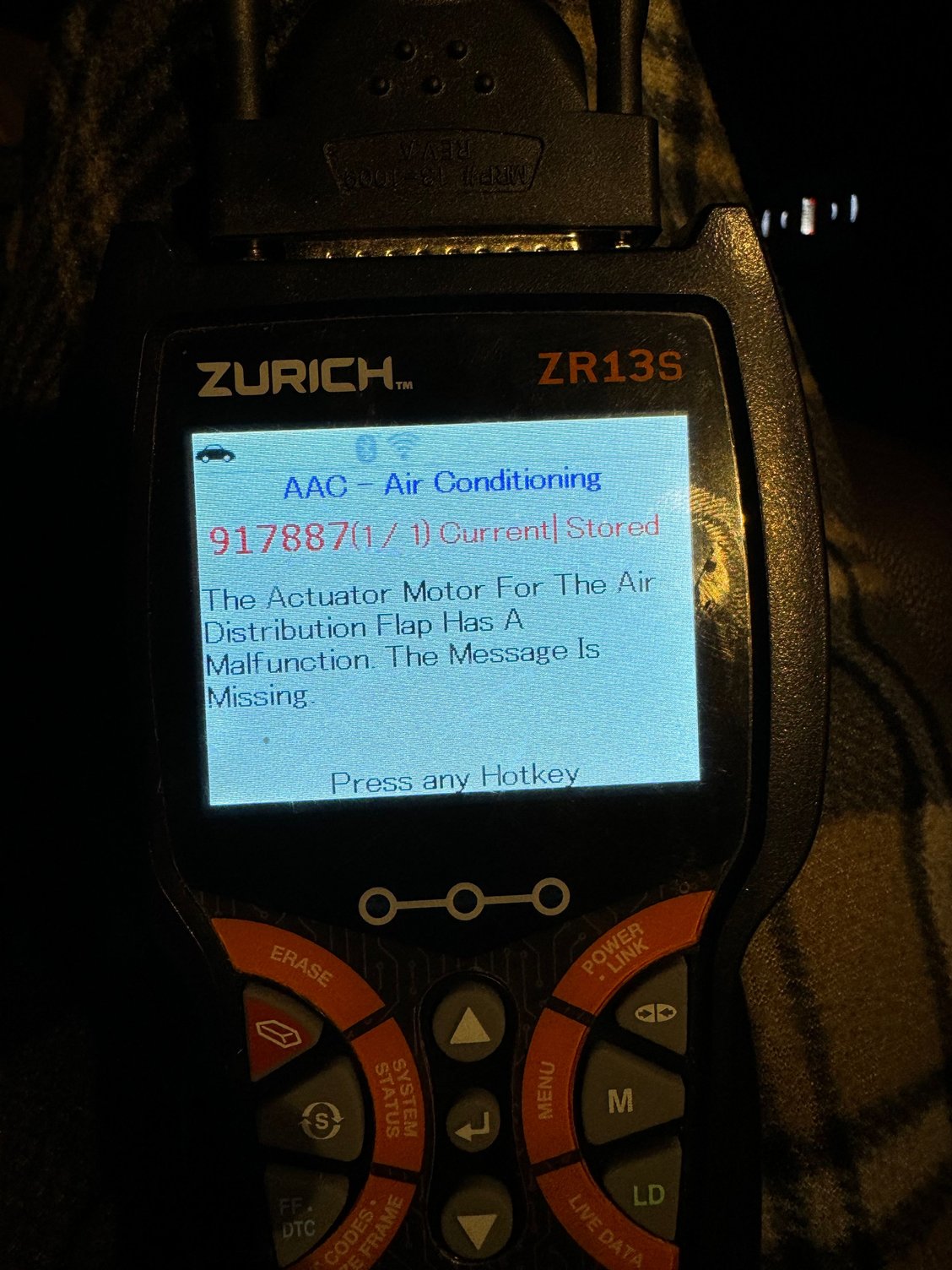

I got an oem one and replaced each one by one. After doing so and putting everything back together I’m still having the same issue. I scanned the car again and now I’m getting “The Actuator Motor For The Air Distribution Flap Has A Malfunction The Message Is Missing:”
does anyone know what’s wrong ? Or has had this problem?
