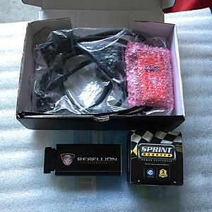

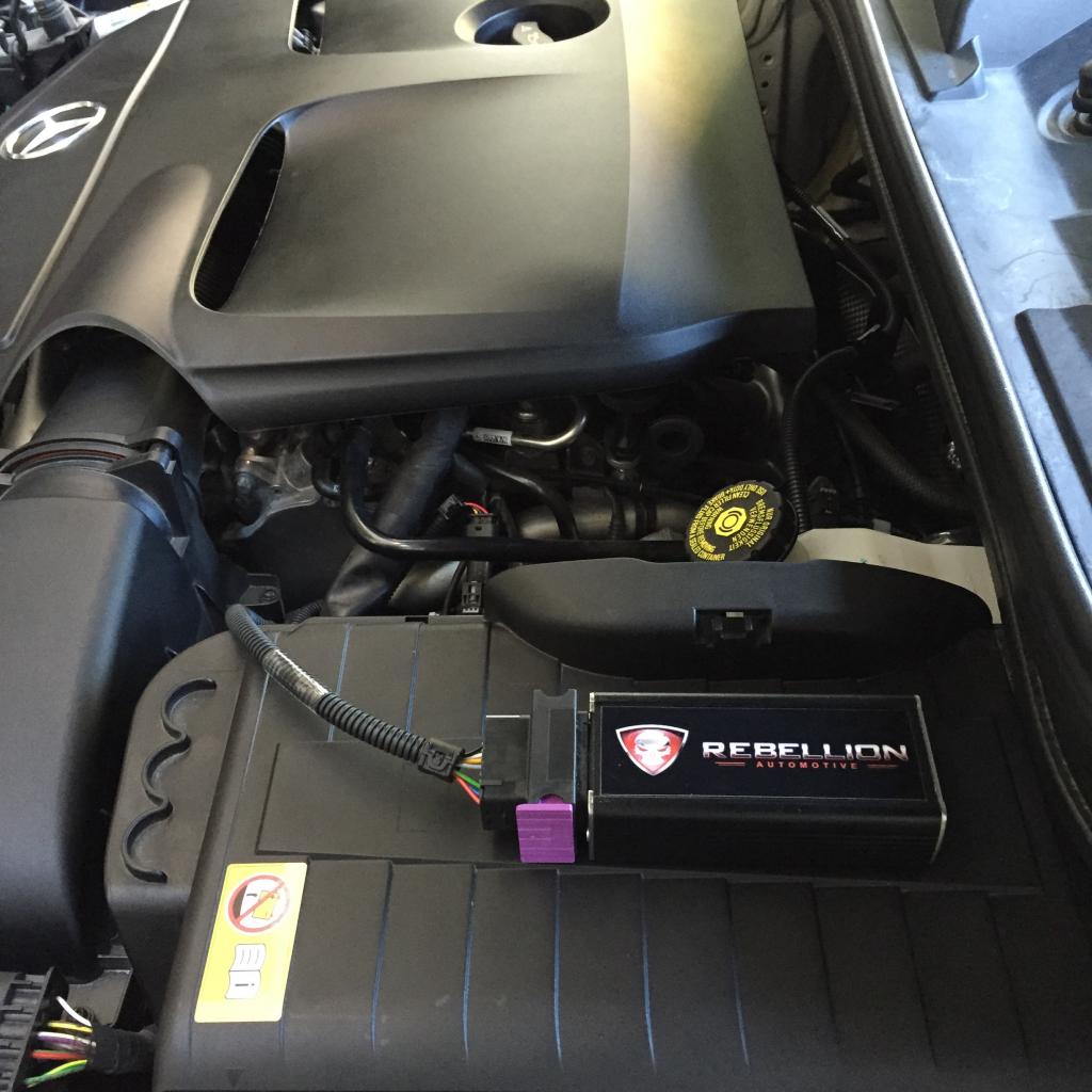

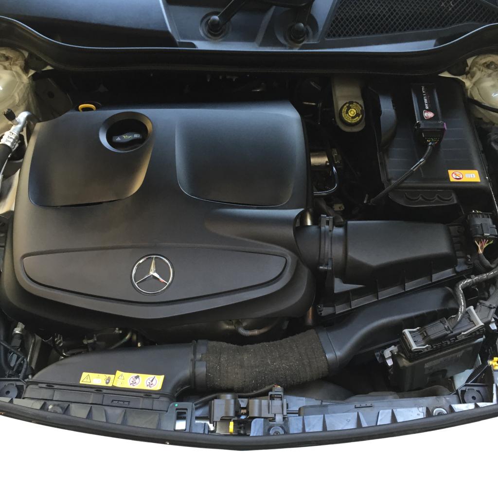

So I just installed my Sprint Booster and my Rebellion Automotive Piggyback tune. The Sprint Booster part # for the CLA is SBME0012S. I purchased the Rebellion tune directly from Matt and received it about a week later via DHL. The installation took me a little longer than anticipated for both but I ca do it in half the time now. Just some tips for anyone wanting to do these mods:
- I took the pedal assembly off by unbolting the 1 13mm plastic bolt because I could not see the clip I needed to pull off for the pedal harness.
- For the 3 sensors for the piggyback tune, you need to pull out the little grey tab before you can push down on it and disengage the plug. You can't just pinch it down and pull the plug. It acts as a lock. Once you plug the tuner into the plug locations, you slide the tab back in to lock it.
