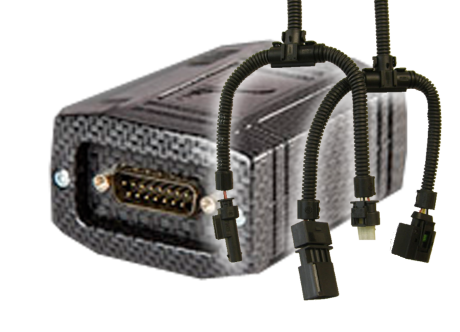

2:About tuning boxes, its so many different.
I have a box from racechip(bestchip) not expensive, only around 320$.
Should raise from 156hp to 203hp. I will try upload picture of my box.
This box only conect to manifold sensor and boost sensor.
But some other boxes also conent to camshaft sensor !?
This meen something, or not importent?

My experience with racechip...
The max noted improvement "MAY" or most likely won't be what you will achieve...
lets say 30% is listed.. you would be more likely to achieve in the region of 15-18%....
This is using the standard or standard plus one or two increments where driveability is maintained, CEL's do not appear, or the timing is not being pulled back...
Of course it can be increased further, and gretaer output achieved, but the M270 again IME, starts to loose some of its smoothness, and can on occasion, despite 98RON, pull back timing on hot days.. (or cut due to knock..)....
These experiences were based on a 250, running 98ron is Queensland Australia (warm and relatively humid) and the racechip ultimate..
You would be doing well to see 180hp without other modifications, of which the intercoler sems the next best candidate...
