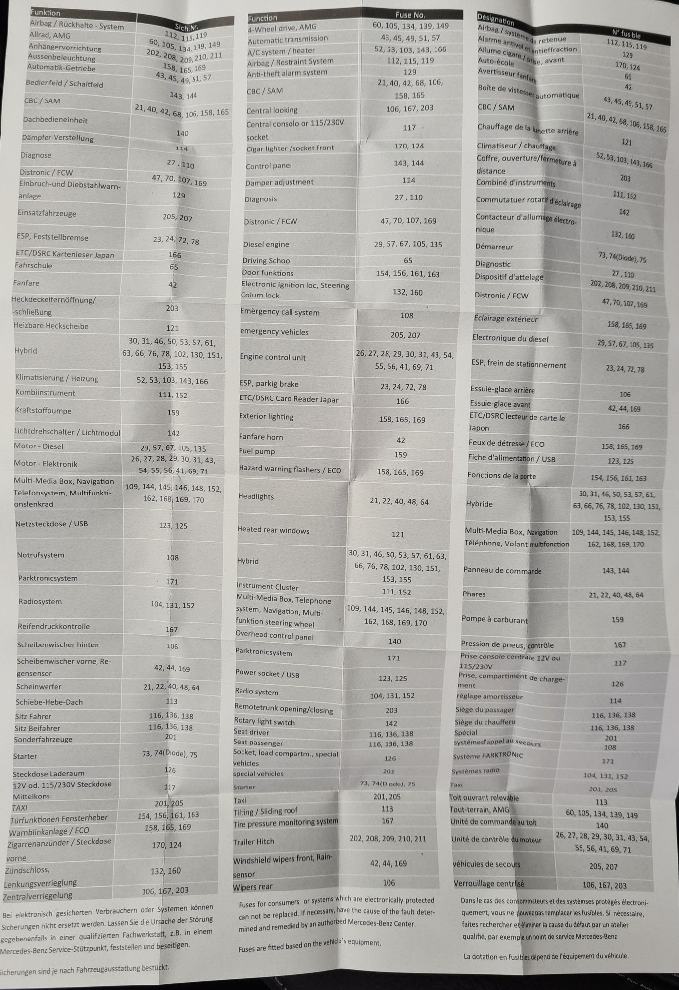

C118 fuse box diagram
fuse box diagram for CLA 250e 2021 premium line. Hope this helps someone because I couldn't find it on the internet and eventually found it folded in the corner corner of the fuse box inside the engine bay. I hope it helps someone. FYI- I used fuse allocation 125 to hard wiring a dash cam. 126 also works.
