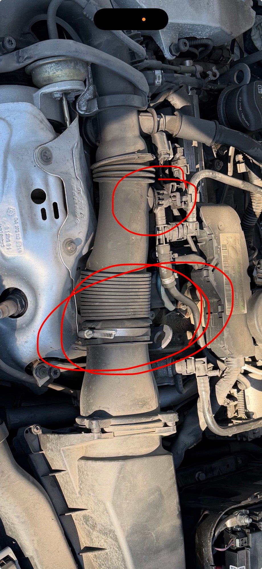

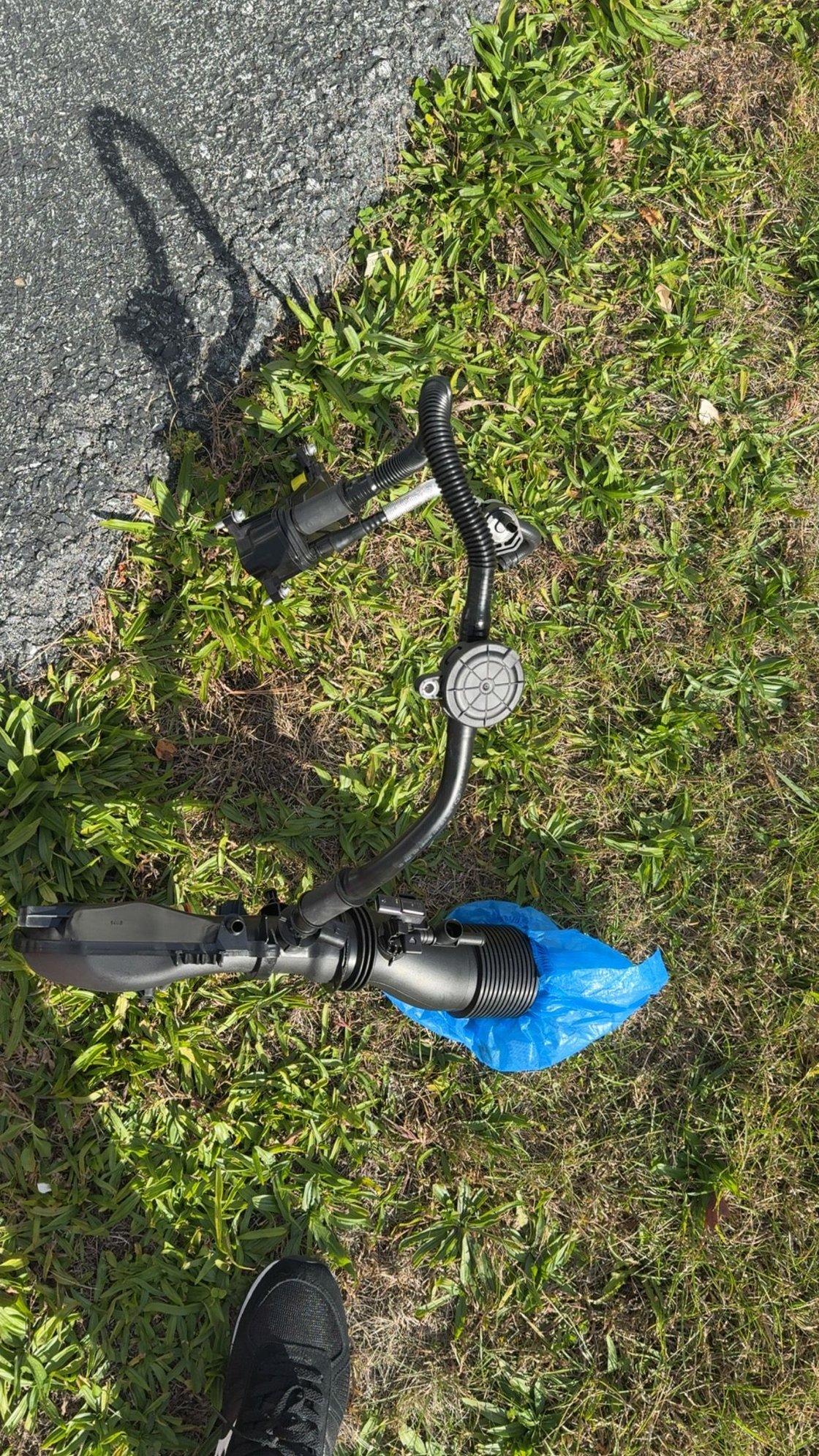

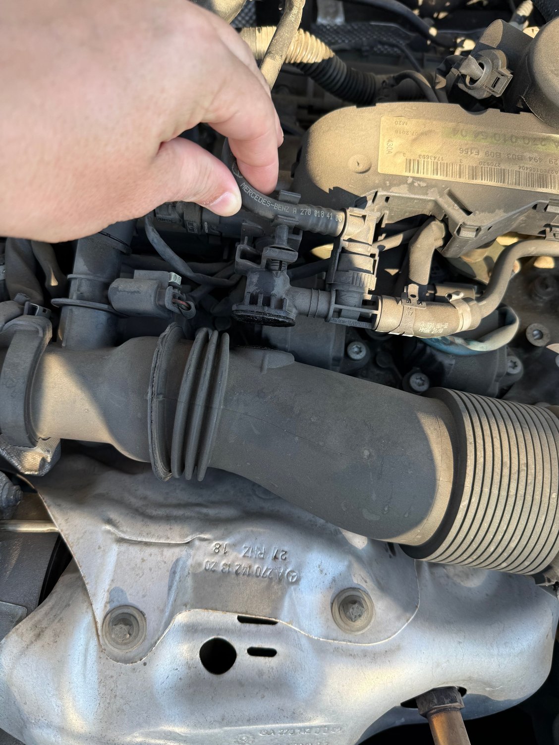

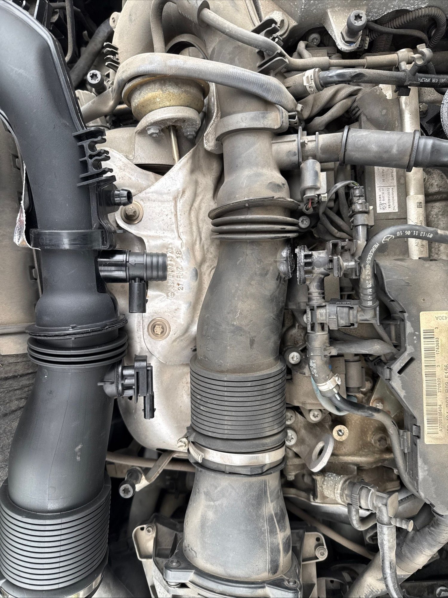

So, I have a 2019 CLA250, and I have a check engine light on. It’s been SUCH a head/stomachache the last 2 months trying to get this thing inspection ready. A few days before my appointment, I saw a crack in my crankcase breather, I will include pictures below. I have been trying everything to get the right part in, do something to make it hold to get the check engine light off for inspection and just can’t seem to win. I spent 900$’s and got a new one online, after ordering the wrong part for 200$’s at first. I now have the part in hand, would like to install it, but I see I have to go all the way behind my engine just to do this, which without having a lift, I will have to jack this up on the floor, remove my front passenger axel, a few “shields?” Just to get in an replace this. Does anyone have any advice on what I should do? Commit to the way I have it about, or do you think maybe somehow separating a hose from the new one and installing it on one of the already current see pieces would be a doable/better option? Please, any help would be amazing, and thank you in advance!
