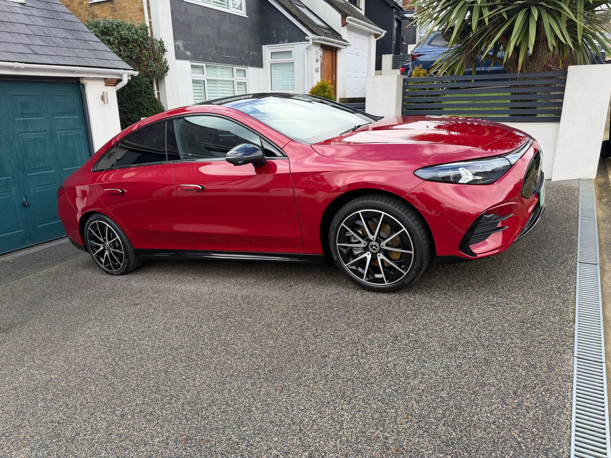

Thanks for the update, I appreciate it.
I will get on to the dealer and see if I can get it updated.
I in Brighton south UK, the car does look good, I must admit.
