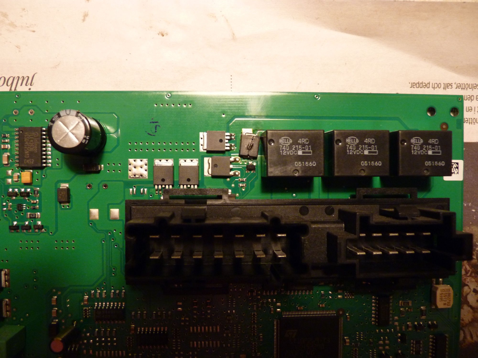

The fuses are located here:
Fuses are intact

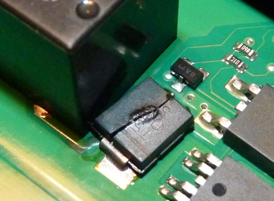

What is this component?

The component is a diode, most likely a power diode given the size. These tend to be common electronic parts costing a few cents to few dollars. Find someone with the part intact to get you the marking on the part and use that to search for details. You may be in luck for a cheap fix if that's the only damage. Good luck.

I have found out so far - it didnt help changing the diode. There were several similar diodes on the card.
I later saw also that several components had been hot. So perhaps a relay had gone as well.
So I have changed the whole SAM - from a A class - didnt need to program enything on it.
