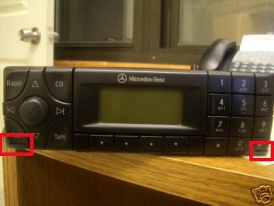

You can get the keys on Ebay for ten bucks. I ordered a pair then got impatient waiting for them and made my own,lol. Two flat strips of sheet metal approx. 2" x 1/2". Grind down one side so it resembles a steak knife. With the pointed end faced outward, insert in the slits on either side of the radio on the bottom. The keys will pull in the spring loaded catch and you can pull out the deck.
Keys should resemble these (you don't need the finger loop pulls):
Insert keys here:
