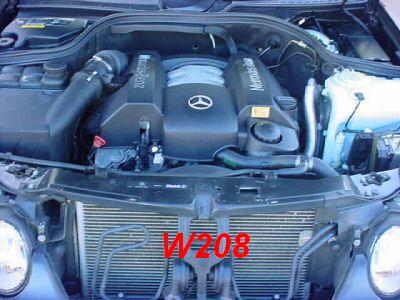

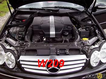

Does anyone know if the w209 (320) engine cover will fit on the W208 (320) engine. I like the way the w209 engine cover fills the engine bay. I know some modding will need to be done but how much? I hate to waste money on the cover and can't use it.

The W208 430 cover looks simliar to the "W209" pic. I would consider one of those since it is in the same family before looking at W209 cover. I have no idea about fitment though.

won't fit, these are intake assemblies, not just covers. By the looks of your 320, your intake is on the drivers side of the block wheras the 430s/w209s have the intake in the rear center.
Therefore the intake assembly will not attach.
