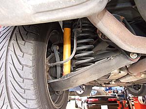

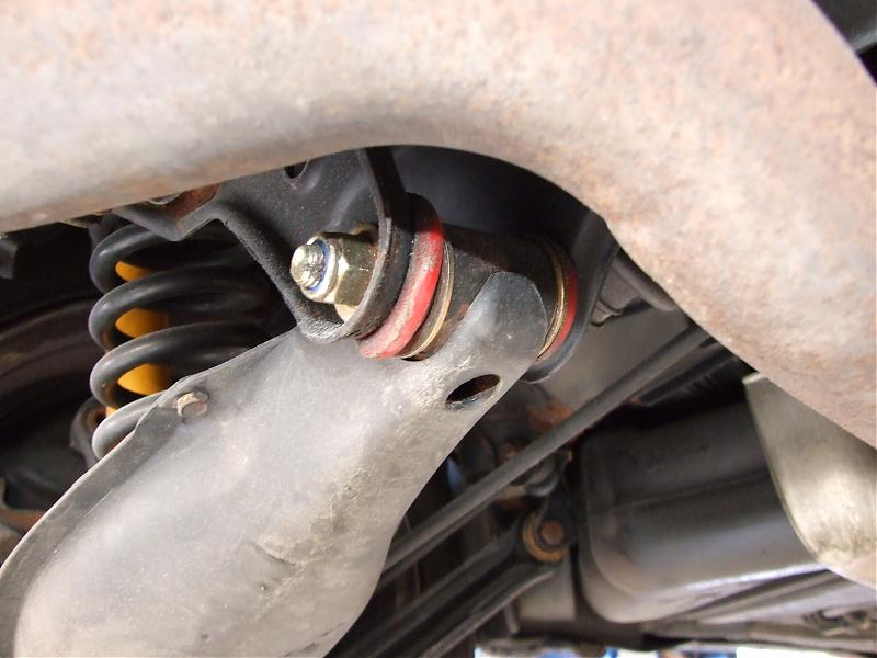

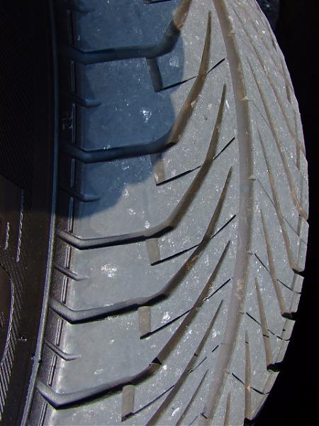

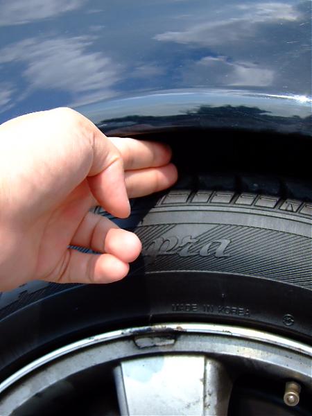

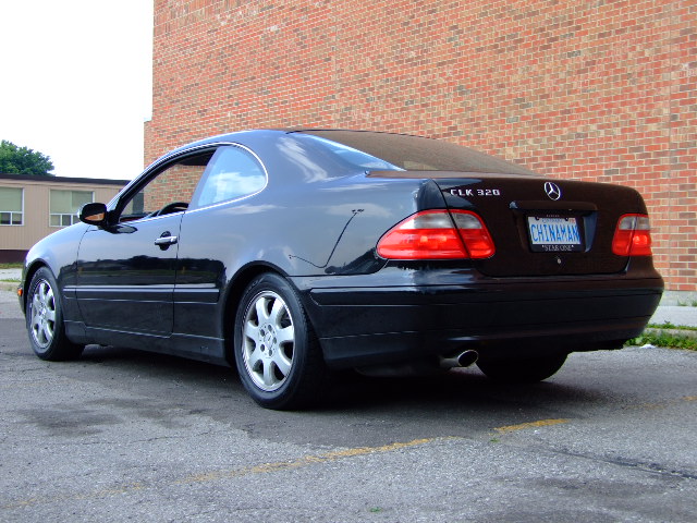

eibach spings, koni shocks (adjustable- 3 settings) and K-Mac camber kits.. are my personal choice.
and when you use #1 spring pads and factory 16' wheels you get the height you see in the pictures.
and yes you need camber kit.. otherwise your tire will wear out very quick..
there is no cheap way about it. choose the right parts and do it right the first time is the only option...
Attached Thumbnails Lowering Car-2007_07220017.jpg   Lowering Car-2007_07220016.jpg   Lowering Car-2007_07220014.jpg   Lowering Car-2007_07290010.jpg   Lowering Car-2007_07290024.jpg
