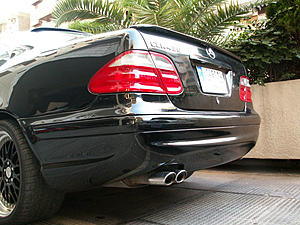

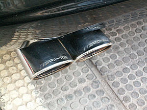

i installed a full AMG exhaust system from a C43, cut the original system after the cats before the Y shaped link, installed the C43 middle / back box, it fit perfectly, the sound is very pleasing you feel its stock before 3000 rpm and after that there is a very nice "sport" rumble... i dunno if i have any performance effect but the engine feels more relaxed in a way ...

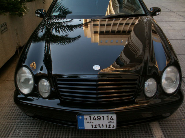

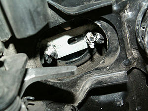

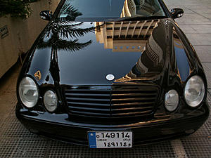

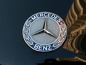

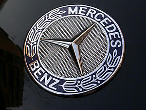

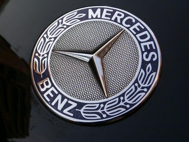

i also installed a flat hood emblem came off an ML no gluing at all!!! i fabricated a little pice of metal with 2 holes and got the plastic pins that attach to it the result is very pleasing!!!

pics :D
pics of the hood emblem and exhaust

did you paint the grill yourself? if so :thumbup:
Old Jul 26, 2008 | 01:42 AM
ahmed18881's Avatar
Joined: Mar 2007
Posts: 285
frankenstein 2001 CLK 430
sry got if professionally done in a body shop
