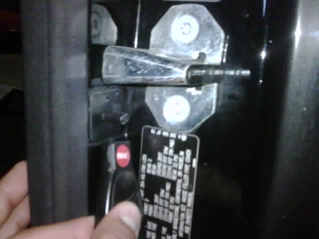

By light I meant whatever switch that makes the DOME LIGHT turn on. There has to be some type of switch that senses when the door is open or closed. I am going to look at my door and see if I can find the switch and take a picture.

Ok, I couldnt find my camera right now so I used my BB Bold to take the pics (Blurry). This is the switch I was talking about. Maybe it is stuck in the closed position and will not activate the alarm?? Its worth checking out at least?
Also, I tried the glove compartment opening with the alarm on and it would not activate the alarm! I am not too worried about that though cause I never leave my windows down so they would have to open my doors anyway.
I hope the pic helps out a little..if not I am fresh out of ideas...
Well actually does your cabin light turn on when you open the door? This will let you know if the switch shown in the pic is working properly.
Greg

^ My man..thank u .... it worked bump.
