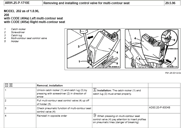

So a friend of mine accidentally popped off the front side of the air control to the passenger seat. (Not sure what its exactly called) It's the controls that let you adjust the cushioning of the seat.
Does anyone know how I can pop the entire control unit off so I can pop it back on? Right now, the front side of it is off, but the back part (closest to the seat belt connector is still connected) I can't seem to figure out how to do it and its driving me crazy.

Arrow Removing the multicontour control unit
Take a look at the attachment. Looks simple enough. I hope this helps.

Thanks so much JayDee. The diagram is just what I was looking for.
