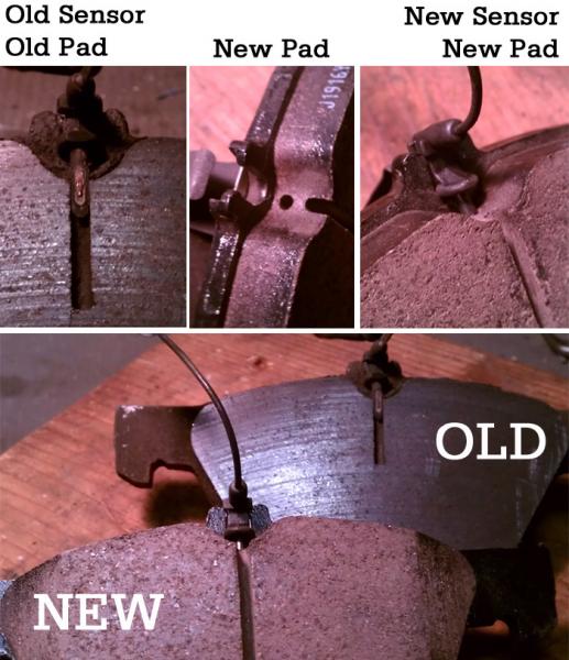

Akebono Euro Ceramic Pads Part #AKEUR853
$61.49 Autopartswarehouse, free shipping.
This set comes from Akebono with two packets of anti-squeak, and two wear sensors. Don't buy it on ebay. The ebay vendors pull out the wear sensors, and sell them separately for a few extra bucks.
Caliper bolts and torque value: 18mm / 115Nm
Sensor connector torx bolt: T40
There are 9 images in this instructional.

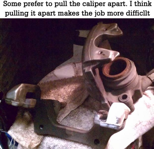

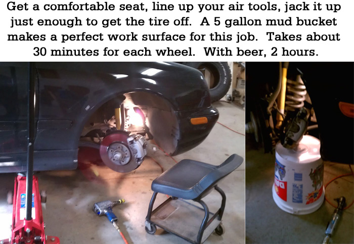

Attached Thumbnails Instructional: Installing front brake pads.-1-box.jpg   Instructional: Installing front brake pads.-1-b-wheel-off.jpg   Instructional: Installing front brake pads.-1-c-sensor.jpg   Instructional: Installing front brake pads.-1-d-caliper-bolts-spring.jpg   Instructional: Installing front brake pads.-1-e-remove-pads.jpg
Instructional: Installing front brake pads.-1-f-caliper-apart.jpg

Instructional continued: Installing front brake pads.
Attached Thumbnails Instructional: Installing front brake pads.-1-g-anti-squeak-paste.jpg   Instructional: Installing front brake pads.-1-h-sensor-install.jpg   Instructional: Installing front brake pads.-1-i-pad-install.jpg

Nice photos! I always took off the plastic cap rather than than the 18mm bolts in pic #4 bolts and springs. This allows you to remove the caliper spring to release the brakes from the rotor.
Apparently both work !

Excellent. I just followed this tonight. Though I must admit I was a bit behind the 30 minute time I ordered Bosch Quietcast from Autohausaz, Bosch has a rebate running now. On my '99 the caliber bolts were 19mm and remember to crank the wheels around on either side to give you better access to the bolts in the back. Thanks for the write up!
