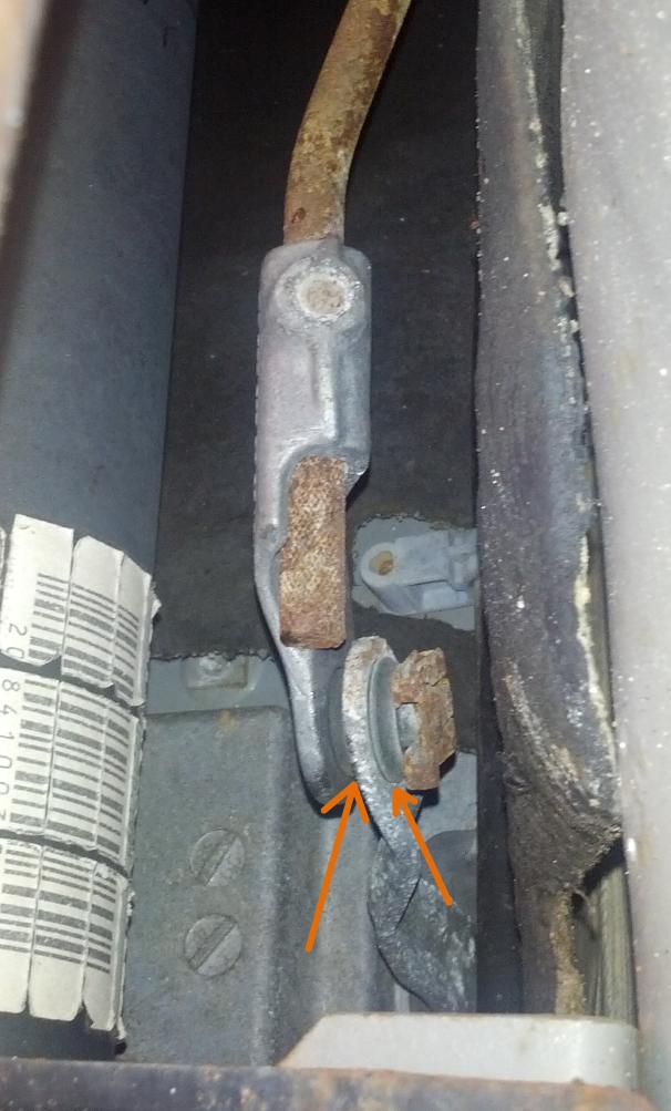

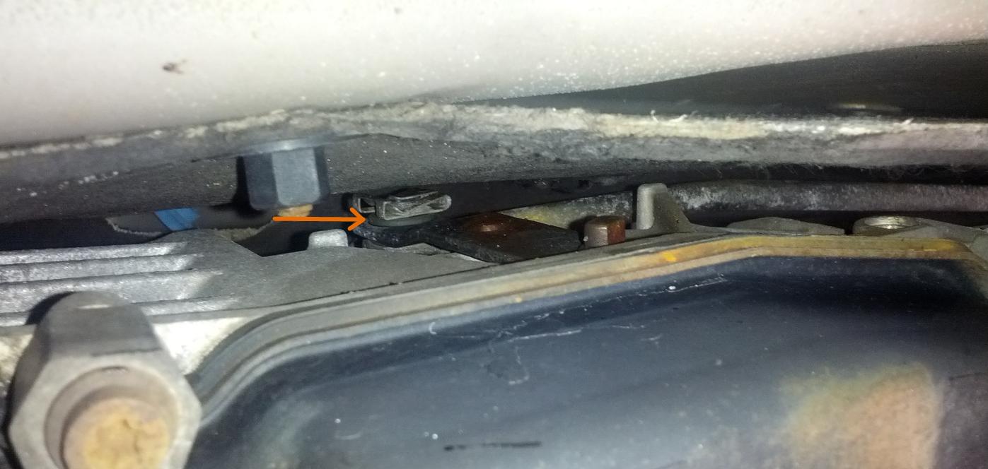

Update: So I got out to the car yesterday. Started it up and everything appears to be back to normal. I drove it around town over some bumpy roads and train tracks to try to make sure it couldn't be knocked loose again. When I go back to the house I put it up on jack stands and tried to get under the car, but the jack stands didn't get the car high enough for me to get a good look. I drove the car about 40 minutes out to my girlfriends father's house to put it on his lift today. Once under there we took a look at shifter rod, intermediate leverl and all the bushings in between. Both of them were present and appeard to be functional. See the pictures below. My assumption now is that a piece of ice or packed in snow got shoved up inside and caused the problem. If anyone sees anything questionable let me know.
Shifter Bushing
Second Bushing
