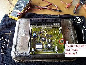

Turned out one of my ignition coils went , I replaced it which stopped the lumpy ride, but my Super charger was not behaving properly. I found that one of my MOSFETS has blown on the ECU, so after soldering a new one, the car works perfect again !

That's quite a find and repair, Its likely most of us will not attempt a DIY repair like that. The ECM internal schematics have been kind of non existent even on older models. I have done some searches on the micro-controllers chip internals and had no luck.
Something must ave allowed the mosfet to fail like a buck regulator or some foreign matter like tea/brew/rain. (hunch)
The WOT event would point at the mass sensor, throttle sensor, Hung clutch on the Kompressor.
Mabye the failed coil fed back into the mosfet?

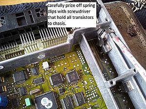

The problem I had was that an ignition coil blew a couple of weeks ago, I replaced this and the car then ran smooth with no misfire. However I noticed that the supercharger was not behaving. It was always on and did not engange and disengage when you reved the engine passed 2300 rpm as it should.
I knew the MAF was okay as I tested the car with another, the crank position sensor was good as otherwise I would have issue starting. I took it to a guy I know who did a diagnostic and said that the electromagnet in the supercharger was not responding and that the whole supercharger would need replacing as you could not get the part separately.? I still was sceptical that the electro-magnet was the issue as it engaged and disengaged when I pulled the plug to the S/C . This is when I knew it had to be a 'control' signal issue.
Searching the forums I I found some interesting ideas on the SLK board which use the same engine, someone had talked about a MOSFET on the ECU needing to be replaced as this gives the grounding that allow the S/C to engage and disengage. So I bought one of ebay for £4.99 and replaced the one on the ECU and the Supercharger now works a treat !! It was going to cost me £400 to get a second hand unit fitted, what a waste that would have been!
I am not taking the credit here as thanks goes to:
Dandywarhol, Subby MrKatz and Barchetta for getting me in the right direction !
If your interested I have added some photos and videos of the results....
Thanks again guys , this is why this forum is so good !
