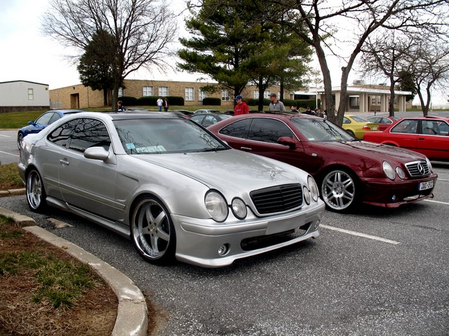

Looking for this Front AMG bumper i saw on the forums.. i cant find it could someone post a link to where i can purchase one? i would highly appreciate it

It's not an AMG bumper, it's a Carlsson RS replica. I can't tell if the center hole support is painted black or removed. Given that these bumpers are all pretty thin fiberglass to begin with, I wouldn't have removed it.
To get one of these you'll have to do a little detective work to find one, and a LOT of prep/finish work if you want it to fit properly. The only way to make it fit like OEM is to cut off the lower part of the bumper and graft it on to an original bumper.
