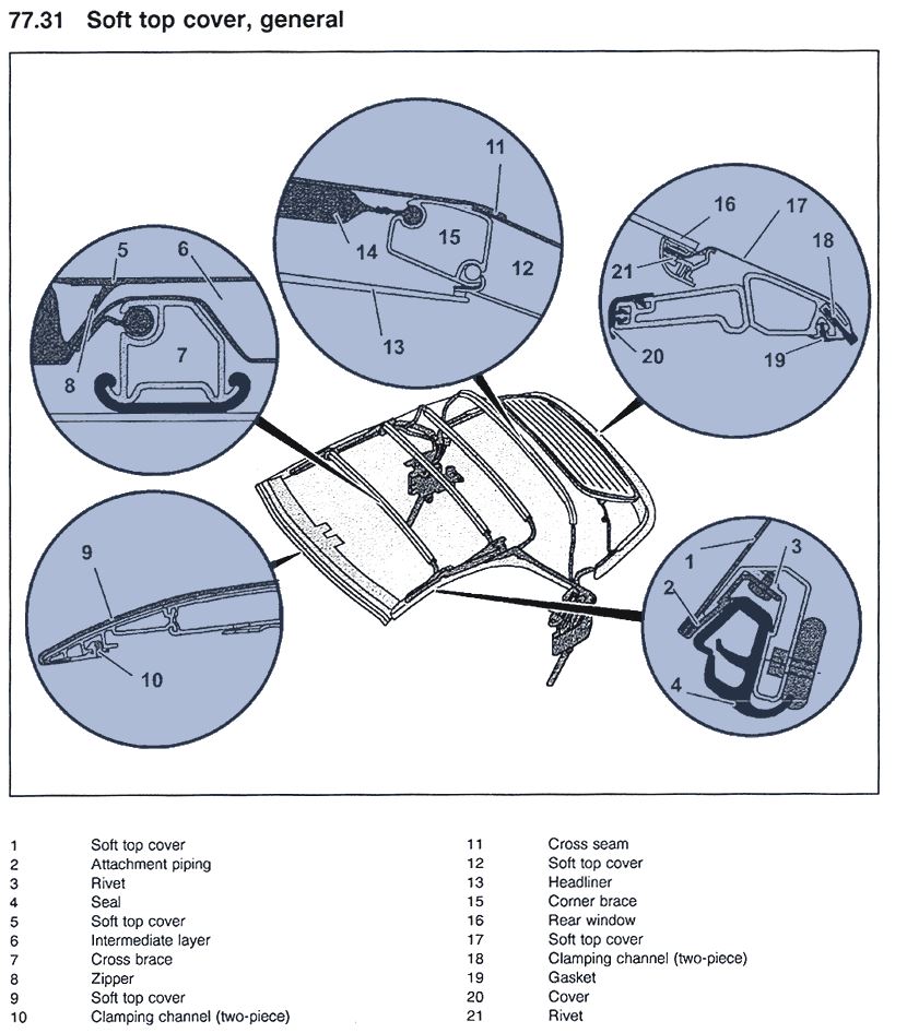

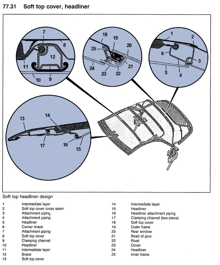

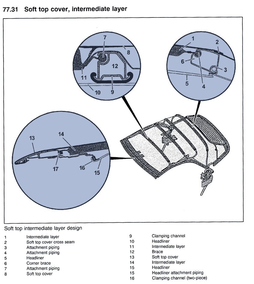

My header seal was coming out in places so I took it out completely ...Now I cant get it back in,plus I,m now not sure how it is orientated.Can any body show me a diagram as to how it fits in the top bow.Old Age is a terrible

Hope one of the included attachments are what you're looking for.

Many thanks Serdipity its exactly what I needed.If I can get it to be any larger it will be perfect ,the old glimmers arn,t working as good as they used to,lol.Number 3 shows the leading edge of the bow and I just need to see the orientation of the seal and how it fits into the recess .Once again thank you very much.
