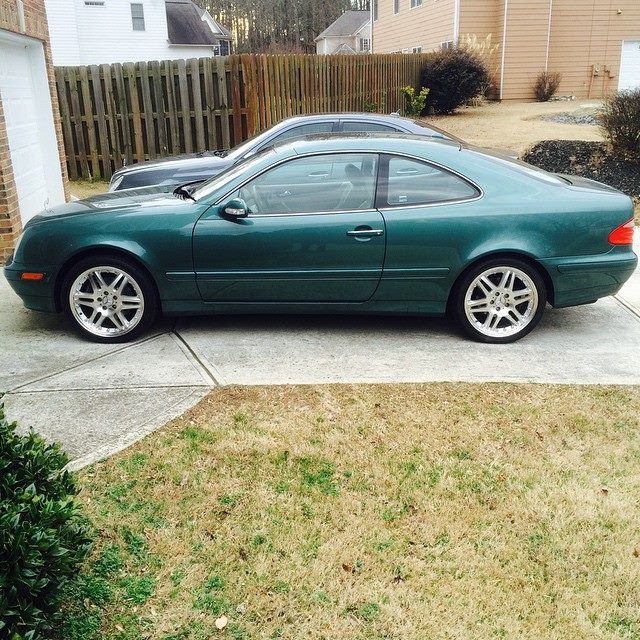

Ok, so I went with 12mm hubcentric spacers on the rear and its 10 times better! And looks good too, I also did find the nipples on the front pads and there is 3.So 3 all the way around, I can fit three fingers in the gap over the front wheels and two fingers over the back. Im thinking if I put 1's on the front it will sit even, any thoughts? Not really trying to lower it just make it sit level and get sports shocks.

Personally I think the stance always looks best if the car is even or at least lower at the front then back.
If you have #3 pad all round then you should be able to get it just right. I agree if you go with no.1 pad at the front then it should give you a 7-8mm drop which is about what you need to get it even. If you find the front is still too high, you will see that on the pad there is moulded line which I have used as a reference guide before and cut the pad down a little further to get the desired drop, it will give you a further 5mm.
PS do you have a spring compressor or are you getting someone to do the work.?

I completely agree, I think front lower looks better. I have my own spring compressors but not the MB ones, I do believe that they will fit. Im kinda hesitant tho because of what Ive read about it being unsafe. On the other hand I was a mechanic for 10 years professionally and have tinkered all my life, currently in production/manufacturing in the medical industry. So I'll recognize if there is an issue with safety pretty quick. Man, I really appreciate your help and input on this!
