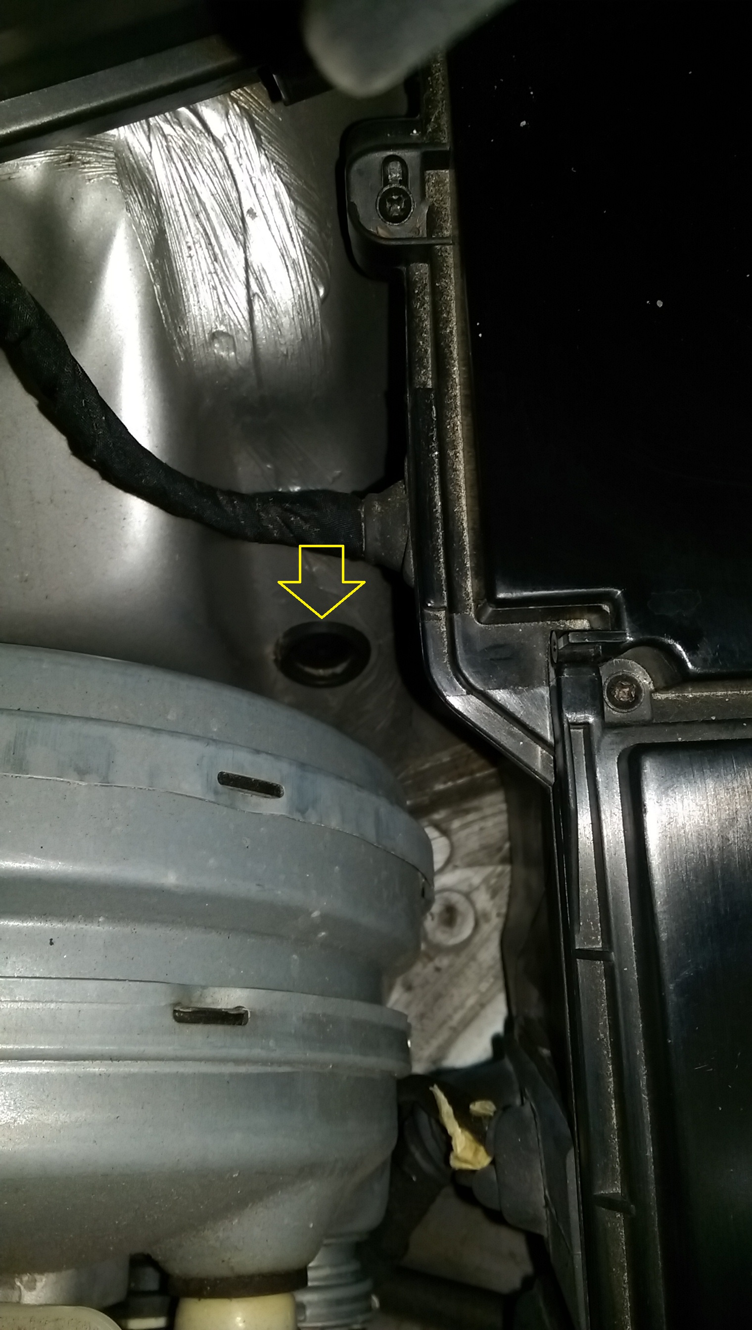

Just installed Sprint Booster on my 2002 CLK430. The SB (Part Number: SBME0002S) is actually installed in the Engine bay (Driver's side) instead of above the accelerator pedal. So far it's been awesome. No more Throttle lag (I set it to Green)!!
The only problem is I cannot figure out how to snake the remote from the engine bay to the cabin. Has anybody in the forum managed to do that?
Thanks in Advance!!

I brought a sirius radio antenna cord from wiper bay to wheel well through a hole that was OEM plugged. It is through firewall on passenger side....comes in to right of cabin filter.

You can run the wire through the firewall plug (rubber covered) on the driver side. Here is a forum discussion with pictures

Burgca, took a pic of the Driver's side firewall. Do you mean this plastic plug ? (Yellow Arrow).

Yes, that is the plug, just pull down the top of the carpet and place the controller in your desired location.
