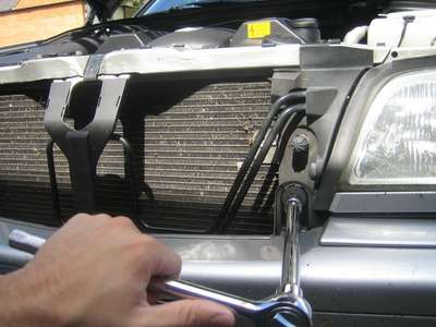

Is this the one you're referring to? That's the power steering fluid line. Your power steering only needs less than a quart/litre. Since you already lost half of it, might as well drain the rest and refill with fresh fluid. You'll most likely never touch it again.
About your transmission. You do have the correct dipstick right? If not, the refill you did might be an overfill in reality and that's really bad. Check the fluid and correct if necessary. Do you know the correct the procedure to check the transmission fluid?
