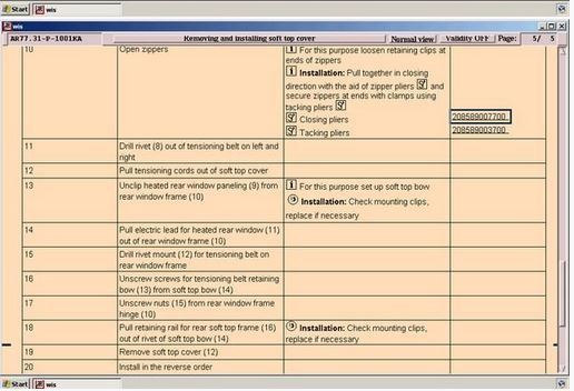

Does anyone have any good instructions on how to remove the cloth from the frame on a CLK convertible? Thanks in advance! Tony

Serndipity, Thanks. I have the car in my garage and will start taking it off in the next week. This should be very helpful. Where can I get images of the procedure with more resolution?

Here ya go....
https://mbworld.org/forums/clk-class...anvas-top.html
