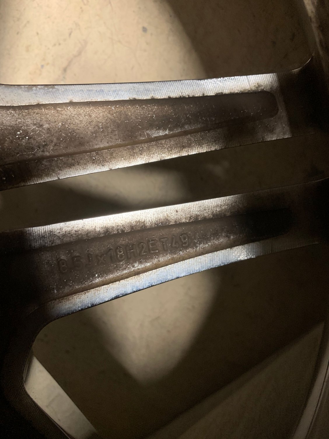

I am new to the site. Appreciate any help I receive from y’all. I put some wheels on my car and the fronts are rubbing on the knuckle. Can I make this fit??
The wheels are 18 inch AMG wheels.
Offsets below.
The D8Jx18H2ET45 are the fronts.
The 8.5 are the rears
The fronts are on 225/45/r18
The rears are on 265/35/r18

Nice, I recommend just measure out where wheels is hitting, and grind down with a file. Shouldn't be too much of problem.

10mm hub centric spacer in the front

True, however depending on your state's inspection rules, they will fail your ride.
Double check with your local laws b4 going that route.
