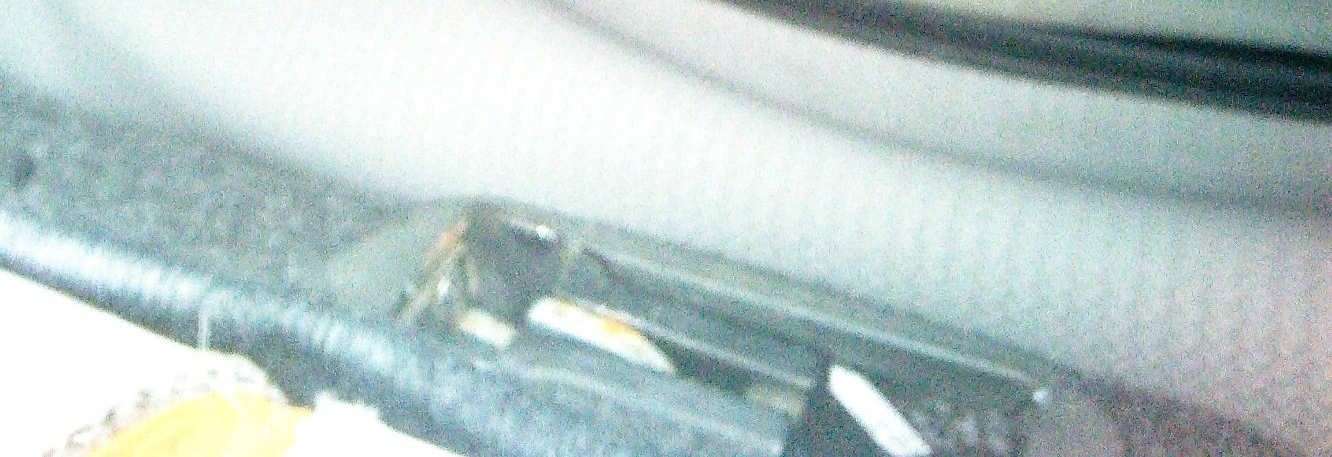

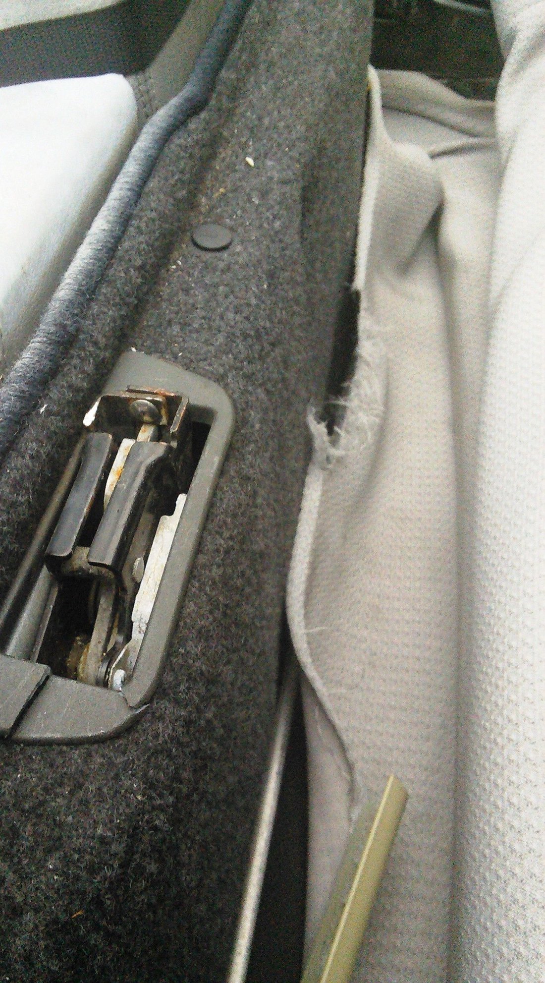

So I always use the roof in manual mode due to hydraulic oil leaking once and never could figure out if worth it to fix it since the car has issues cosmetically anyway. In any case.... sorry to come across as a newb but I would greatly appreciate any advice for the following. I can donate to site if needed. My mechanic did not know how to fix. In a nutshell for some reason i can dump the soft top into the back per usual but when i try to close the metal closure on top of trunk the latch wont penetrate ( for lack of better word lol) the receiving metal portion. This portion is the same portion that requires the benz wrench tool to open the metal portion to allow the soft top to be pulled out. I have tried the tool but the receiving latch here stays closed and stuck and will not accept the incoming cobalt blue metal closure to lock it all down in place. There is nothing visible in the way nor those annoying side flaps. Any input i smuch appreciated! Thank you so much.

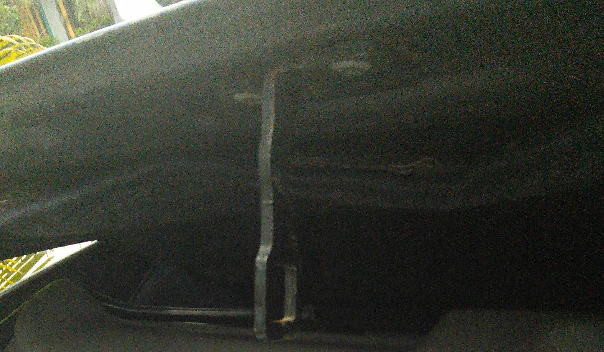

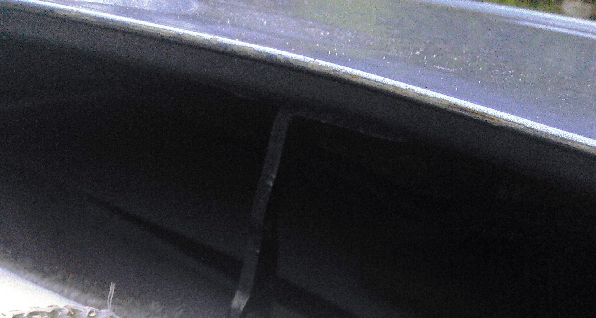

well i made progress and was able to get latch down and issue seems to be trunk is staying open and keeps opening on its own as if there is pressur eon it. I was able to get metal latch to stay in place and locked to fully secure the top down. Problem is now the trunk is jarred out ward about 10-20 degrees.
Is anyone aware how to fix so latch is properly aligned AND trunk can close and no gaps or overlapping. Why is the trunk and or metal closure near trunk able to be manipulated like that by just pressure.
