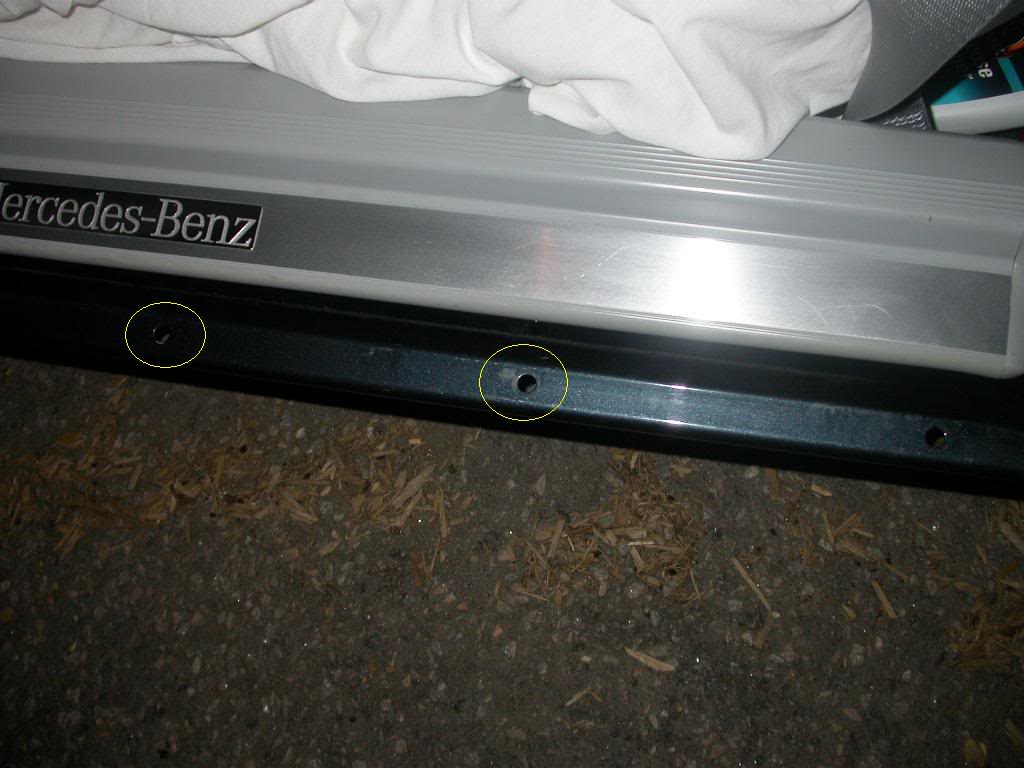

There are 6 black twiss locks located under the car. Use a flat head screw driver to turn them. Then remove the 2 8 or 10mm screws and 1 pull snap. After that the skirt is attached to the car with plastic snaps. Be careful not to break them. If you do.... the MB dealer will have them.(I had to order some myself.) Hope this helps.
