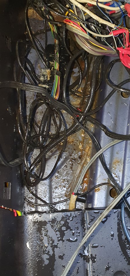

Is there anything that we are missing maybe immobiliser related? We also appear to have a blocked scuttle drain on the passenger side so the passenger floor is wet. Is there anything in this area that could affect the car starting? I'm not very familiar with the electrics on the car
we've had the passenger side carpet up and someone has put oil where the module is to stop rusting and the module is swamped. Is this the ECU?

OK so we're finding this module to be the gearbox ECU (correct me if I'm wrong. Plus, we're seeing the Mosfet Semi-conductor (BTS42GL1) has the centre pin of 5 which is repairable, however leg 1 is destroyed where it goes into the chip so there is no surface to solder to.
Looks like we need a new board.
Can anyone tell me if the gearbox modules are plug and play interchangeable please?
