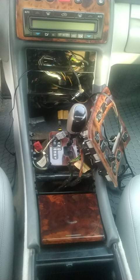

A few hours dedicated to it which allowed me to improve some cons. Sorry for the bad quality pictures. Taken directly through a social media app which lowers the quality by a significant amount.

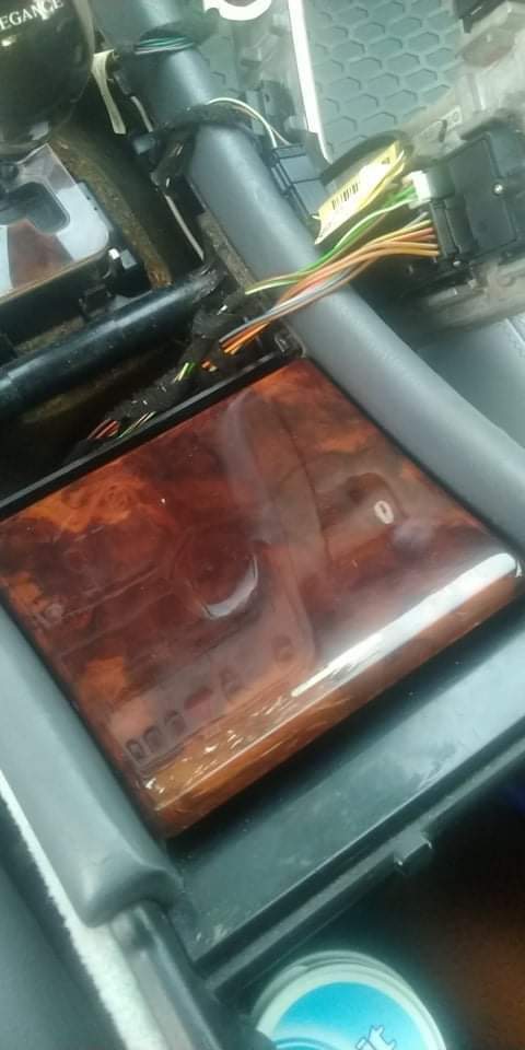

  • Able to reroute de microphone cable through the feet air vent carpet. Had to take everything but the A/C module. A little bit of modern, comfort tech for phone synching and call answering.
  • Removed dome light cluster and used compressed air to clean the A/C thermostat fan. No more loud noise coming from it. Specially when the car is stopped.
  • Replaced the right side tweeter cover. Broken by a previous owner. Now even has the insolating foam.
  • Replaced cup holder wooden trim for one in a better condition. Small things yet with detail.

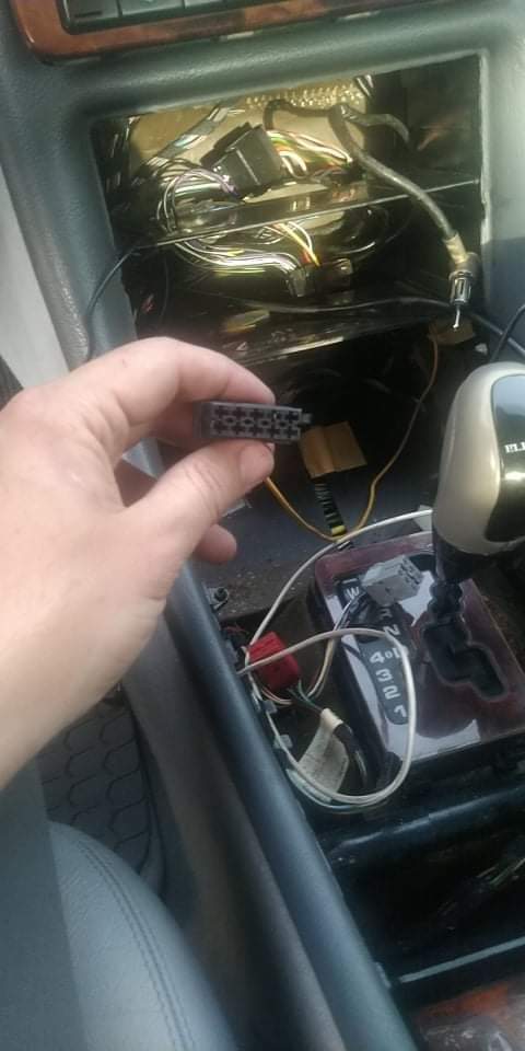

Issues found:
  • Shelf cover cable for the switch was mangled. Someone cut the connectors and united the cables to keep in an open loop.
    • Looking at options: Either find the respective plug and crimp it or remove original plug from switch and create new crimped connectors.
    • I really wanted to keep things as original as possible.

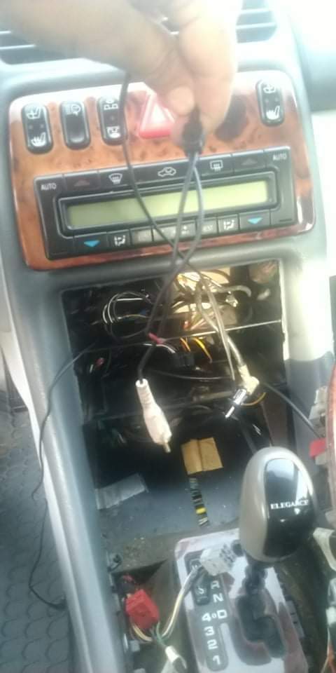

  • Some previous owner went to the trouble of snipping the subwoofer RCA right connector.
    • Found a white cable which is running alonside the centre console tunnel however I don't have any idea what is meant for.
    • Correct me if I'm wrong. On one of the pictures below, the big plug with a single yellow cable was meant to provide power to the subwoofer?

Some pictures from today.
The switch position sensor missing. Cable hidden under the carpet without the original connector.
The "genius" work. Leaving the Left RCA channel untouched but cut the Right RCA (red)
Is this the power for the sub from the original radio?
Original has the varnish cracked and found a suitable replacement.
Part of getting acquaintance with your car.

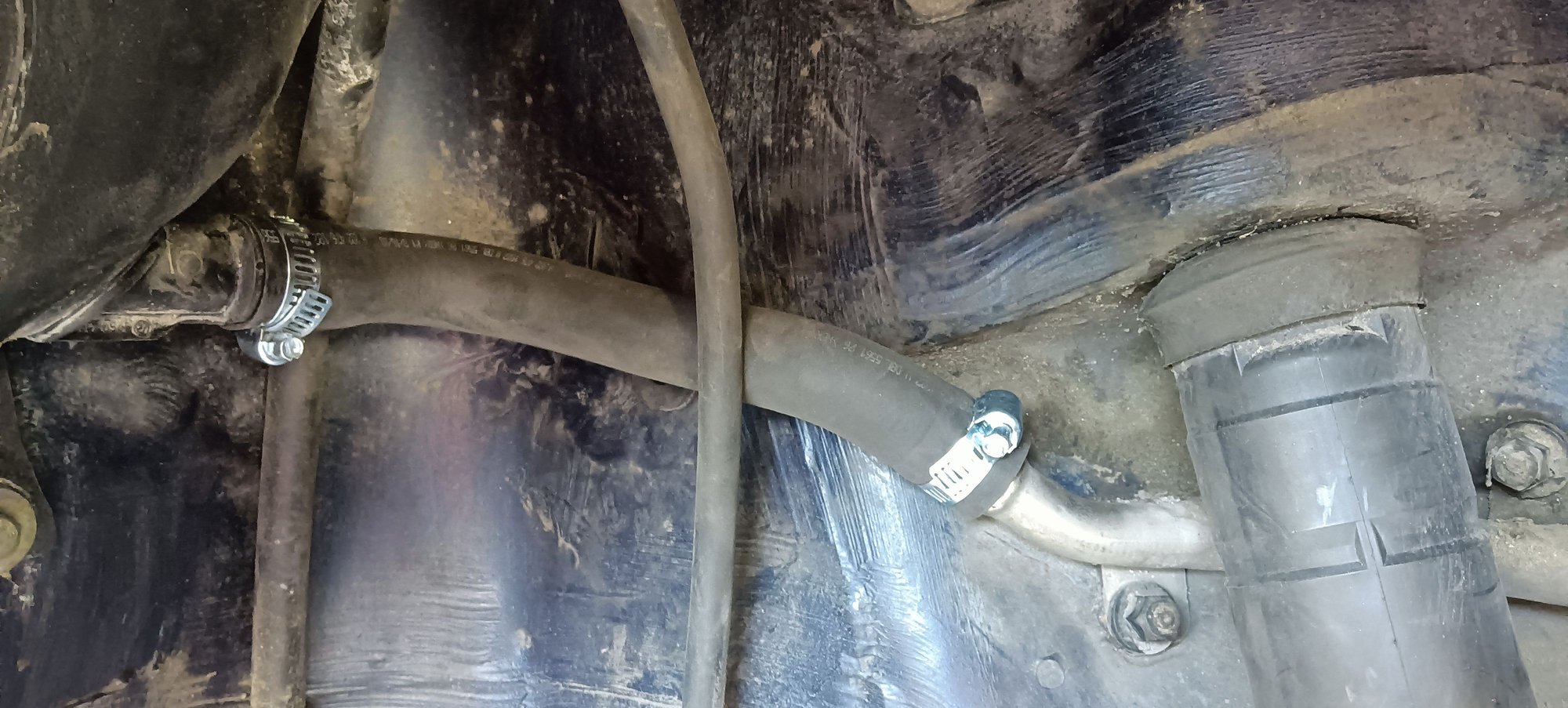

Leaving here important information regarding the two flexible rubber hoses from the fuel reservoir. Almost no information about the exact size.
As known, there is a chronic issue regarding the two houses identified as A2024761827 and A2024768726. The hoses become brittle and perish. Whenever the fuel reservoir is filled, gasoline saps out and spills on the rear right arm and the floor. Quite a lot.
There are videos on YouTube to identify the specific place however information is lacking about their size. Thus, I want to share it with anyone who still hasn't changed them.
Difficulty level: Beginner
Tools: Needle-nose Pliers, Clamp cutter, specific rubber hoses.
A2024761827
  • This tube has two different sizes.
    • From the canister side it has an external diameter of 24.24mm and internal diameter of 17.63mm
    • From the metal pipe side it has an external diameter of 21.79mm and internal diameter of 14.15mm
    • Wall thickness: 3.5mm
A2024768726
  • This tube can be sourced from any store as long as it's a proper fuel rubber hose. Mercedes couldn't source it.
    • External diameter of 21.42mm and internal diameter of 14.32mm
    • Wall thickness: 4.15mm (generic)
After changing and clamping them down, went to the petrol station and filled it up. No longer I smell gasoline after filling up and no longer spilling!
A2024761827
A2024768726 (generic in image)
Pan out of both hoses
