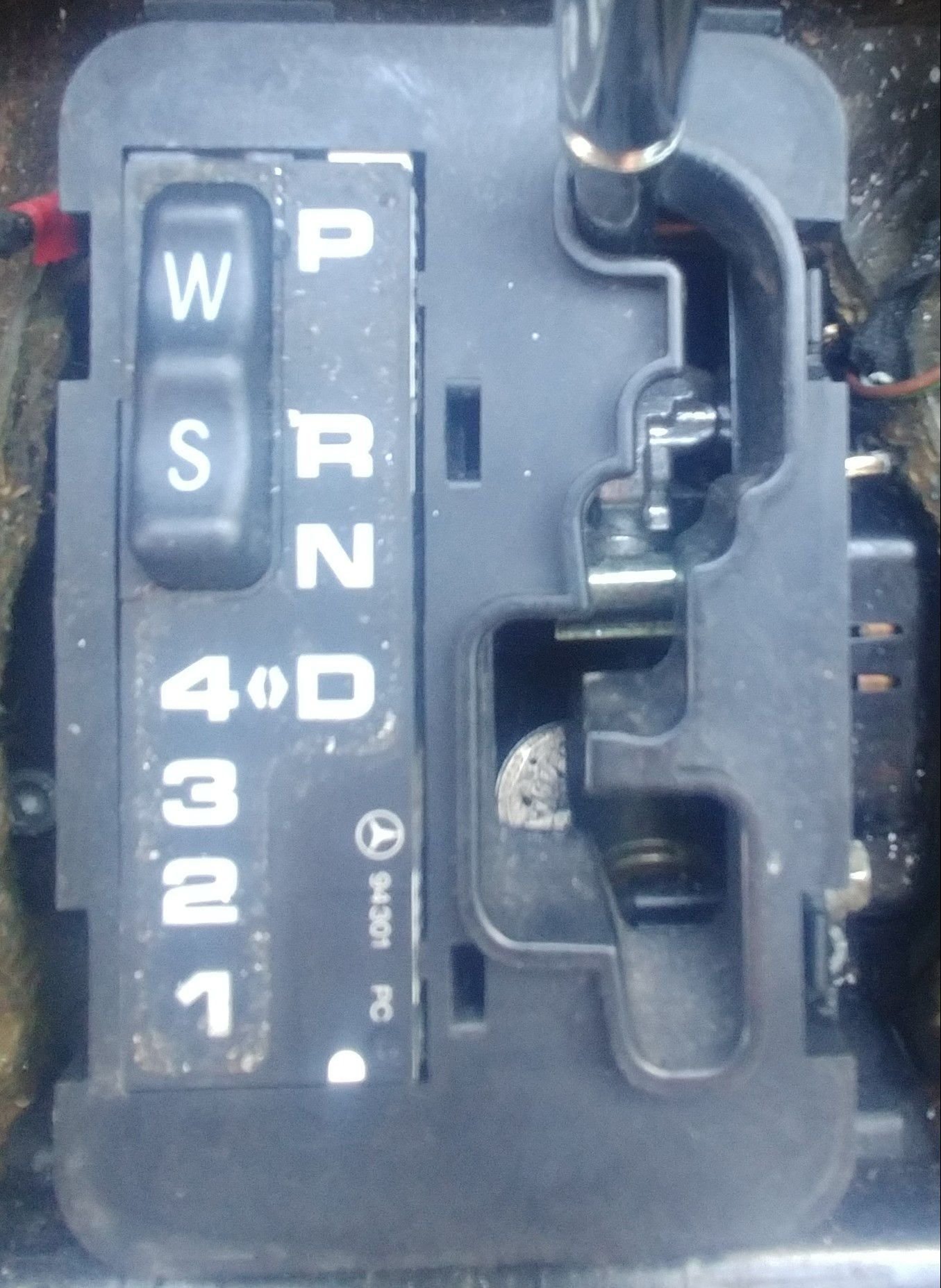

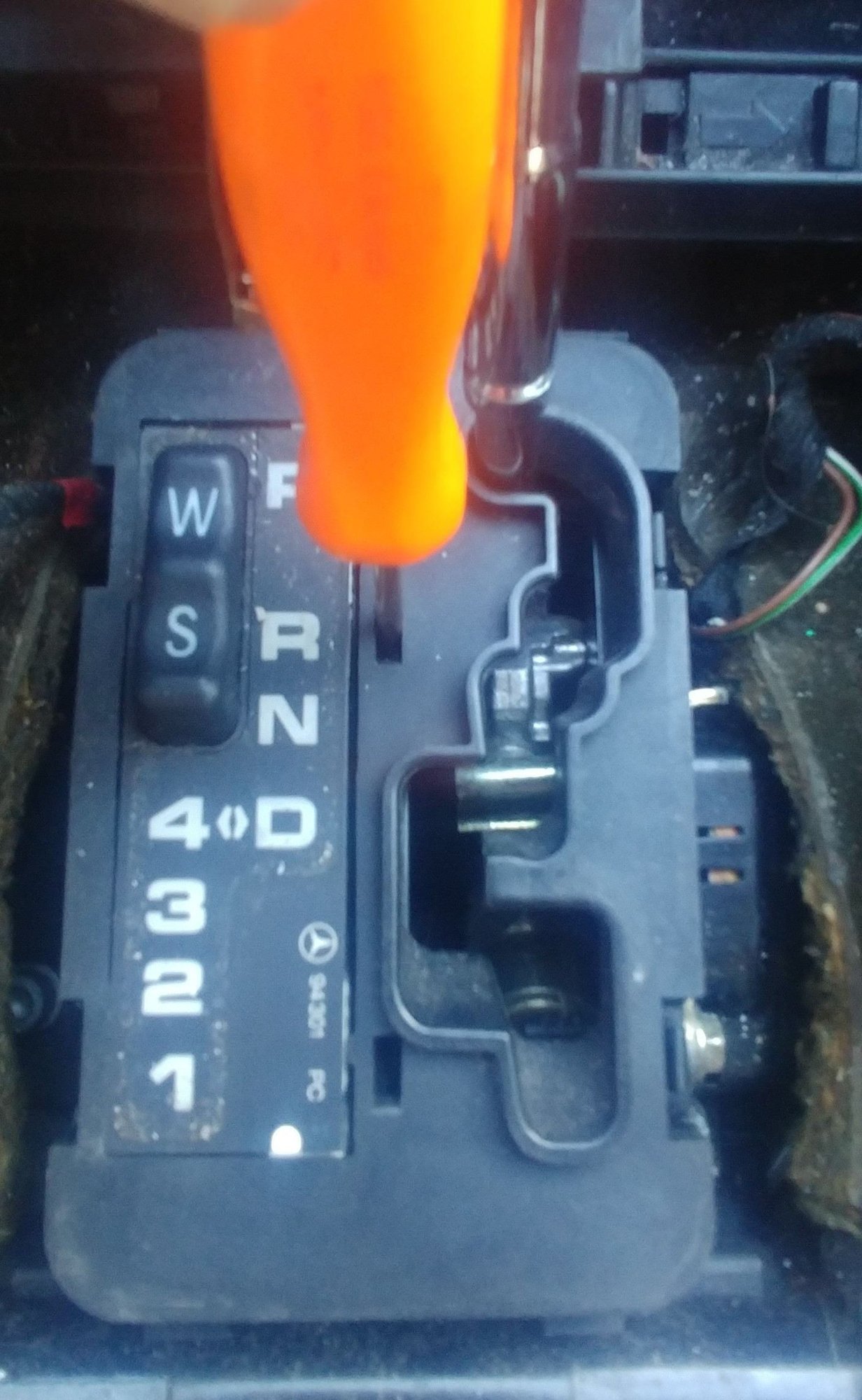

I'm sure this information is out there somewhere, but I couldn't find the information for my year, so I figured it out myself and decided to make this post for the next person who may need it.
Here is the shift lock release on a 1998 CLK 320 (W208). It's hidden underneath the shifter cover. Pics attached.
