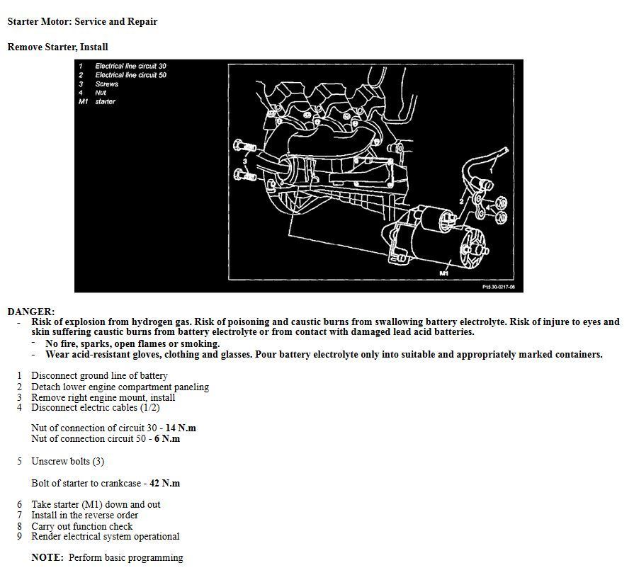

Here are the MB WIS instructions.
Very much appreciated! Thanks!!
