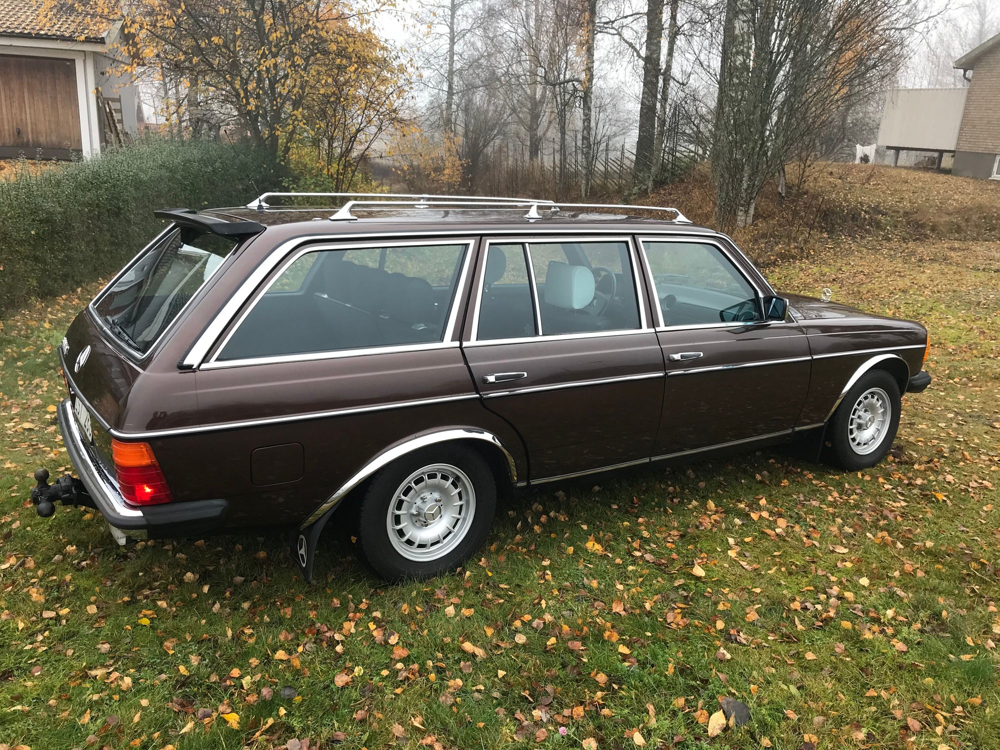

Here is some of my previous mercedes projects
500E new painted
500E with Eissenmann exhaust
500E with R230 AMG wheels
300 TDT
