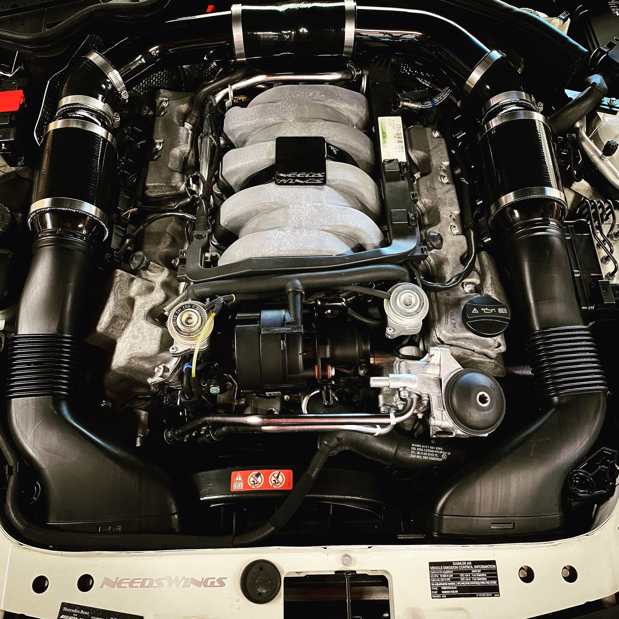

Intakes
These??

Originally Posted by nyckid
LOL why would you want to make your car slower by turning what is essentially a ram air setup that feeds the airbox with outside fresh air to a couple of hot air intakes with oiled filters that will eventually mess up your mass air sensor? The only dyno proven HP solution is the AMG airbox or one from a 320. Exposed filter in the engine bay = slower car.

Renntech Or NeedsWings have the best intake systems. Both are spendy but keep hot air out of the intake. The system you have pictured is literally sucking hot air in and could not be a worse modification for performance. I have the NeedsWings setup. Zero to negligible power gain but looks and sounds cool. M113 series V8s are not intake limited, they are seriously exhaust limited (headers/cats). For a stock car, just keep the stock filters clean or if you must spend extra money, buy a reusable filter like BMS, Green, or K&N.

Do not do this. Your intake temperatures will increase greatly and you will develop a lagging acceleration from a dead stop. This will result in a loss of torque with no HP gain.
The air box is not only designed with a cold air and ram setup, the internal design smoothens airflow past the air filters through pressurization.
The exhaust end is not too restrictive. Elimination of catalytic converters do nothing without ecu tuning to compensate for the increased flow. If you want more noise, you can elect a straight through exhaust, but keep the cats and pipe diameter the same. Larger piping cools the exhaust too fast and you will lose torque again. Headers are indeed restrictive. Kleeman headers are the only ones I trust after seeing them first hand. There are clones on eBay where the welds are not smoothened in the tubes, creating restrictions, and potential cracking in the future.
Cam profile for these cars is meant for torque around town, and midrange on the freeway, not HP. Top end power requires different duration cams, freer flowing exhaust, and ecu tuning.
