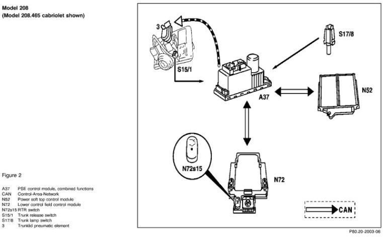

As diagrammed below, the trunk lock on cabriolets operates differently than the coupe models.
During MY 2001 production, trunk lids were fitted with a green emergency trunk open switch, often referred to as a hijack button.
It works by electrically powering the A37 pneumatic pump to unlock the trunk however, it does not perform the same mechanical unlatch as the push inward of the fob's metal key, nor is it readily accessible because of the cabriolets roll-bar assembly.
By design, to prevent a collision between the trunk and soft-top compartment lids, whenever:
-the roof is in process of being opened or closed
-the roof is closed, but not properly locked
-the roof is open, but not properly locked
The N52 soft-top control module cyclically sends the following CANBus digital messages to the central locking module, "SOFT TOP CLOSED", "SOFT TOP UNLOCKED" or "SOFT TOP OPEN", so that the pneumatically operated central locking system will no longer allow either the key fob, center console remote trunk release or the trunk lid emergency button to open the trunk, which is why you will need to use the metal key for access to the soft-top components located in the trunk.
