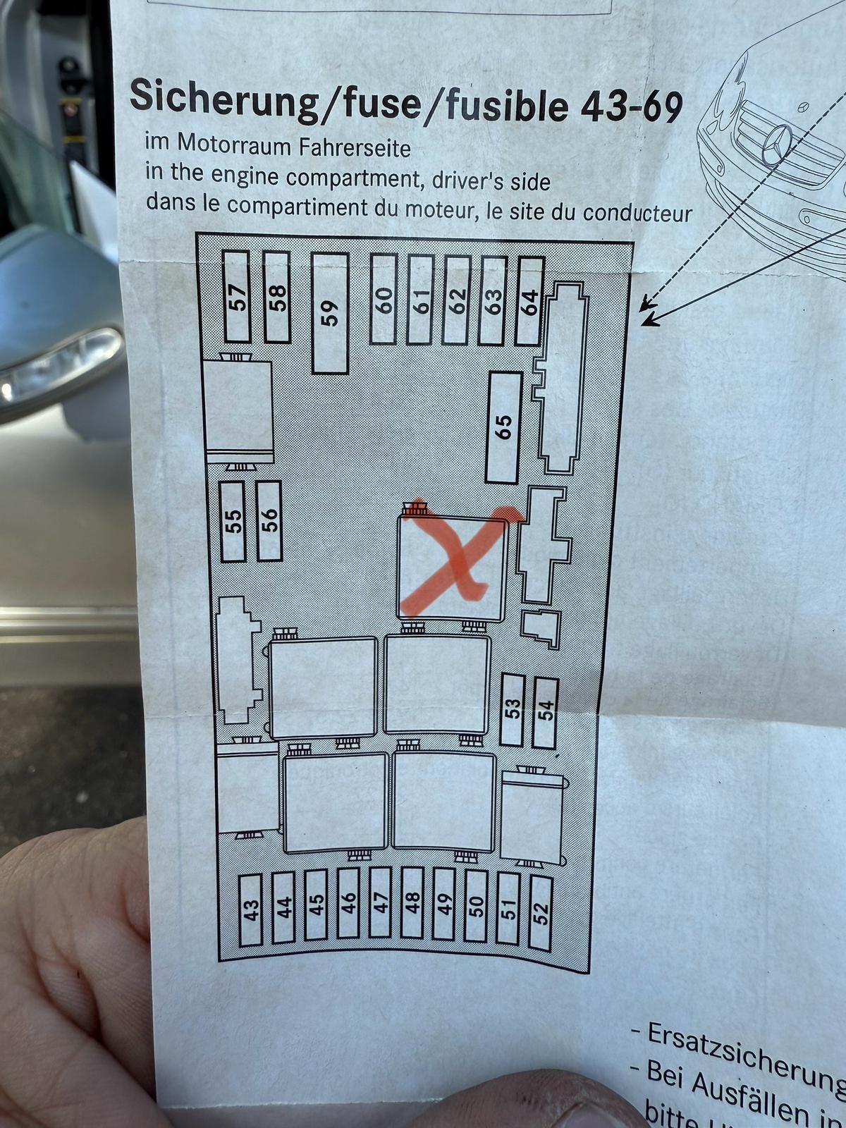

I had the exact same symptoms on my 2004 W209 with M112 (240) . All light come on when turning the key (except Water Temperature which remains 0 or blank) and few seconds later the Radiator Fan goes on full speed.
It turned out to be from the start enable relay (I read here that someone called it K40). It is one of the black relays on the front SAM. Marked with Red Cross in my photo.
I opened the casing of the relay and pushed it by hand and Voila everything worked.
Just to make sure I swapped the two black relays and the symptoms changed. So, that was our bad guy.
