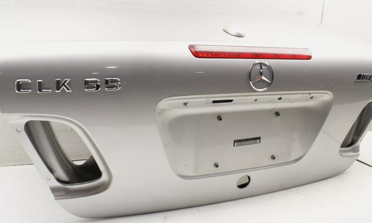

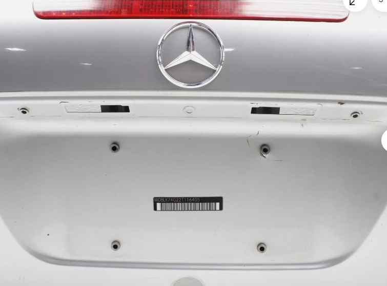

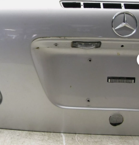

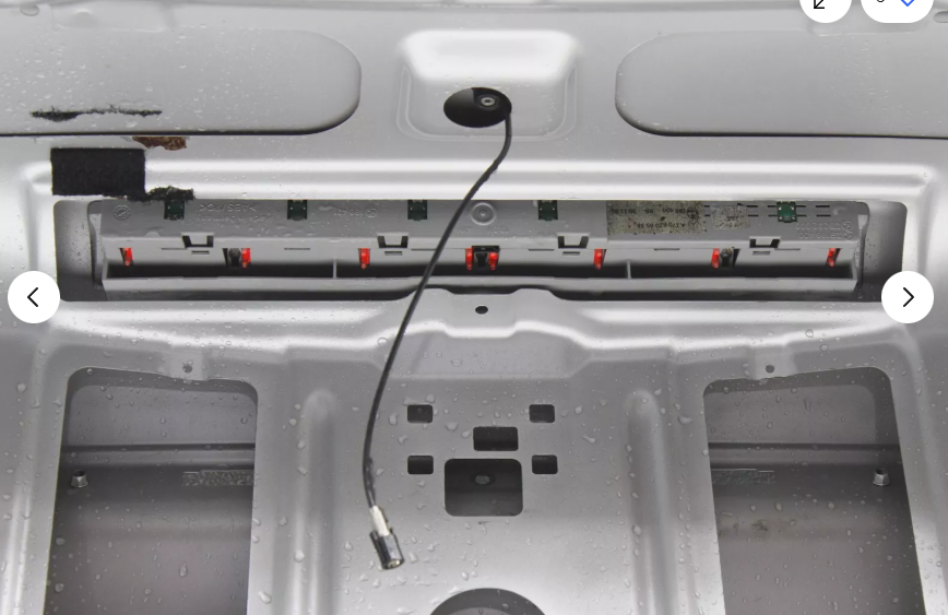

was looking for examples of the trunk to see what i could find and i found an ebay listing of the trunk without the trim attached
it looks like it needs to be removed from inside
looks like the lights are attached to the trunk and not to the plastic houosing
looks like the lights are attached to the trunk and not to the plastic housing

finally got around to removing the trunk liner so I can gain access in order to install a backup camera( side note if your getting a camera with a screw make sure it is closer to the camera itself rather than the back as it will not fit properly into that middle hole had to learn that the hard way)
anyways the screw has a square base in order to be removed I used an 8mm socket and it unscrewed pretty easily its held on with some rubberized sealant and can be removed with a flat head screwdriver which takes the nut and the seal off at once.
