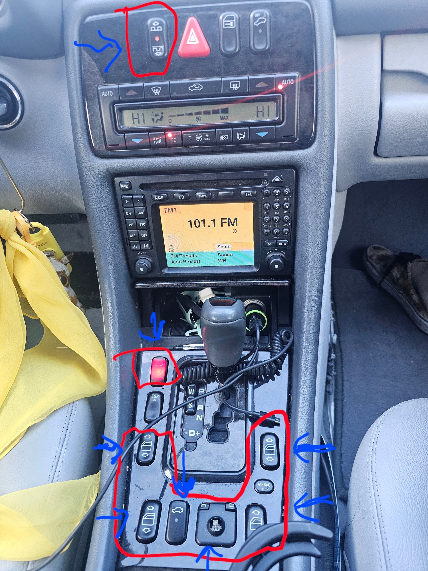

1. All four windows not rolling down
2. Window lock light illuminated
3. Convertible button illuminated
4. Left and right mirror adjustment won't work
5. Truck release button on central console not working
6. Lumbar adjuster not working

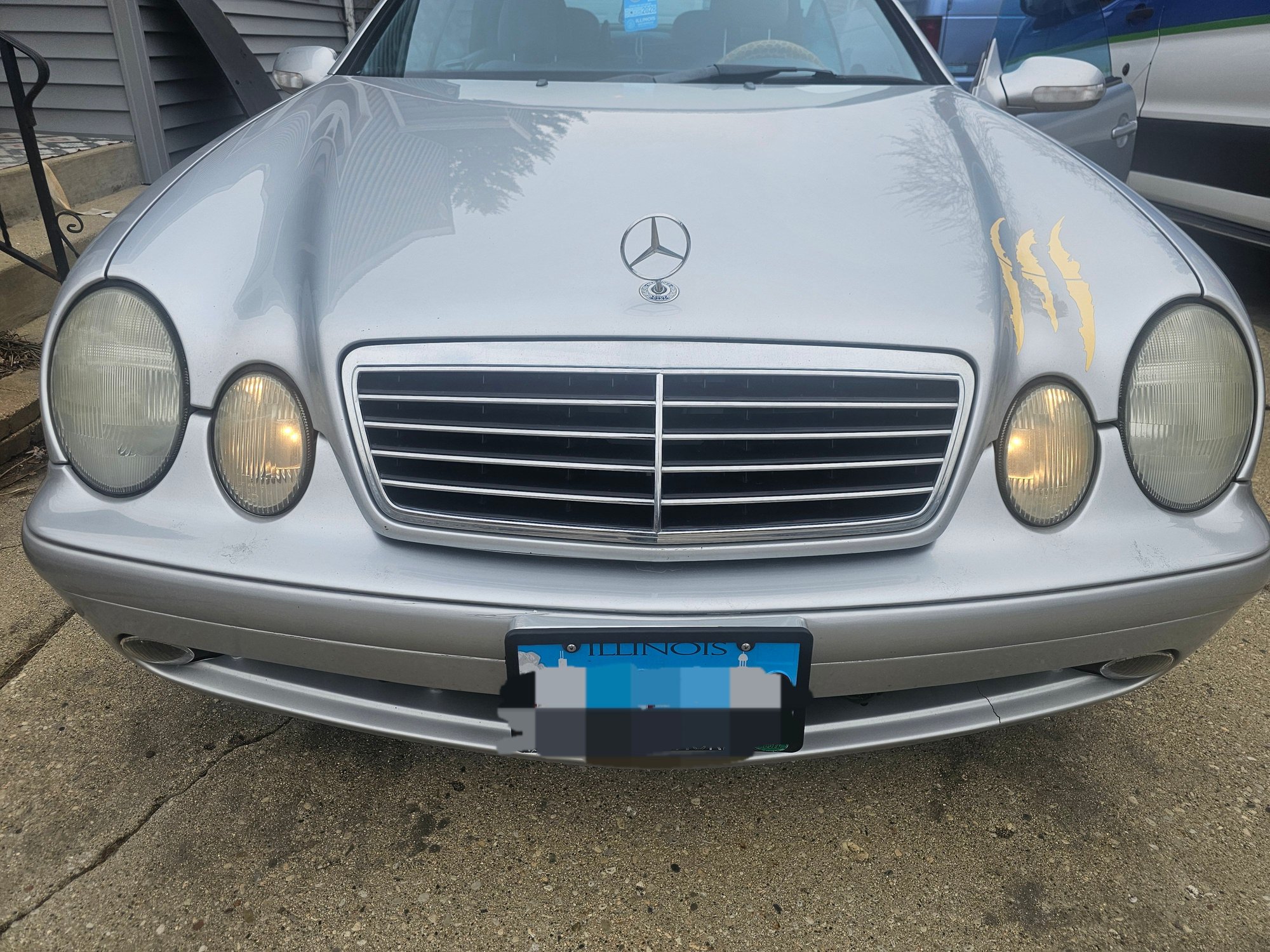

7. Lamp Defect Malfunction
8. Gas gauge flashes every once in a while
-The last time I had everything working (minus the lamp defect) was on January 19th and I attempted a window resynchronization. We had issues starting it, because my father let the car sit too long. The first attempt to start the car was on January 10th via a battery charger. They let it run for 30 minutes but didn't drive the car very far, just around the block. The car wasn't attempted to start again until I arrived on the 13th but it wouldn't start. I was told they would get it charged again for me to try and take home. On the 16th, I came to pick up the car and found out that the battery was not charged with a charger but via jump started car to car (which I later found out is really bad for Mercedes). ABS, ESP, BAS, and Lamp Defect malfunctions were on the screen. I drove it over an hour away back home and had no problems with iusses 1-6, 8. I drove it on the 17th back to my father's home. On the way back my home, some deer ran out in front of me and I slammed on the breaks. After slamming on the breaks, the ABS, ESP, and BAS malfunctions were no longer coming up but then problems 1-6 started. As far as the Lamp Defect goes, my low beams are affected. They will turn on but are very dim even after replacing the bulbs, I'm still having this issue.

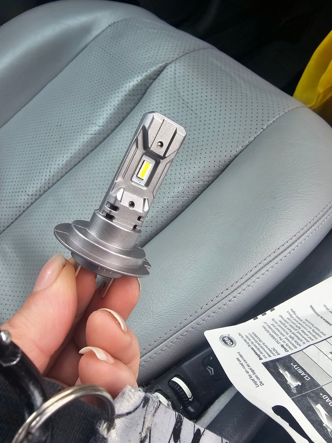

Low beams only:
​​​​With high beams on:
When I replaced the bulbs, my father had these ones (they're also the same type as the high beams):

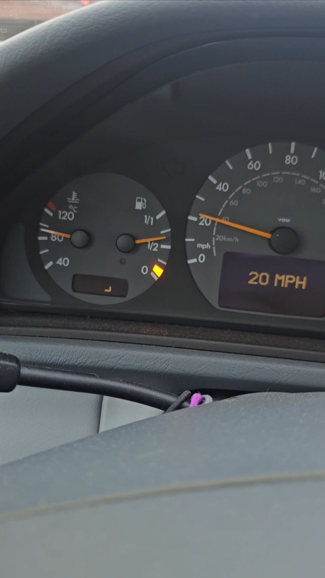

For 8. so far three times it has happened since driving it on January 16th the gas gauge flash (even though I wasn't my anywhere near empty).
(But flashing)
As you can also tell, the weather temperature gauge also isn't illuminated all the way.
