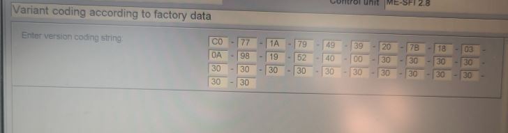

Greetings everyone. I am reaching out to you for some help with getting one item of coding completed on my C208 Auto to manual swap that seems to be preventing ESP from working.
Via implicit coding, I was able to edit/save items 0162, 0164 and 236. so the car starts with auto shifter and TCU unplugged. Drives like a BEAST! - so much fun.

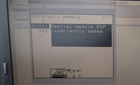

Error appeared after unplugging auto shifter/TCU. I even tried an ECU from a manual CLK from Europe.
Error appeared after unplugging auto shifter/TCU. I even tried an ESP unit from a manual CLK from Europe (e.g. 0295452232) but I still get the C1511-005 error - "Control Module ESP incorrectly coded."

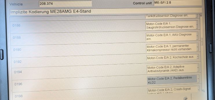

Upon checking my ECU in implicit coding (Xentry clone) I finally located the string for Pedal curve (Pedalkennlinie - item 0196) and every time I try to set it to KLD2, it says it saves it but it wont save. Is that because that option in the ECU is locked? (BTW I also tried to use my Launch X431, it sees the option and when I try to update it, it says unable to communicate).
Every time I try to save it, it
Every time I try to save it, it "saves successfully" but wont stick.
Alternately, if someone could help me identify the correct byte in this Variant coding I could also try here. BTW In this string, byte 7 (changed from 26 to 20) and Byte (changed from 2E to OA) was changed for ETC/EGS and Gearbox.

The issue with the ESP incorrectly coded error (C1511-005) and the inability to save the Pedal curve (Pedalkennlinie) setting could be due to several factors. Here are some steps and considerations that might help:

So, you successfully changed byte 7 and 11 and the Pedalkennlinie is not accepted? Anyway, KLD2 is the correct setting for manual.

@trigital Correct. I was able to take a baseline pic of the Original Variant string, then I actually used implicit coding for the TCU/ESM, and those took successfully. Then then came back here to see what string values changed, and took a pic again. When I originally did the swap I saw on a forum that the Pedal curve option was 0342, but my coding list didn't even have anything past 0300 (all reserved). I guess that was for a different car. I sent another year trying to figure out why ESP was offline, I tried swapping 4 ESP units now with no success. Then recently I started seeing more and more items on the importance of this pedal curve so i started digging again.
It was my Launch scanner that helped me identify it since it shows them in English. So I discovered that mine is 0196 (which I just found a few days ago!)
So this is where I am - Xentry Dev mode says it saves, but it doesn't stick, and the Launch X431 can't write it (error message saying failed to communicate)

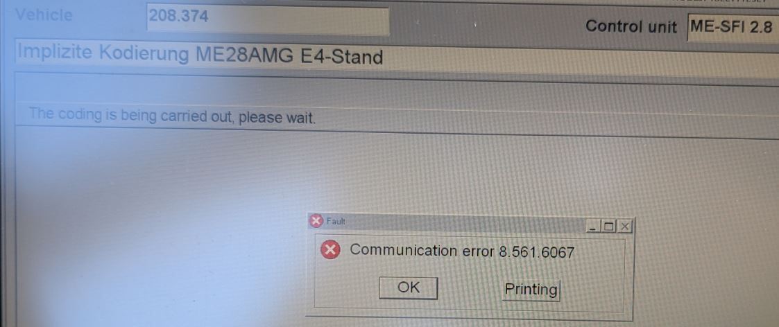

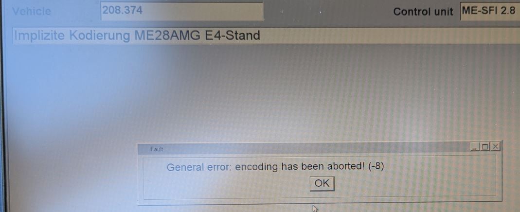

Update on coding retry
@trigital
I tried the steps you suggested but this thing still wont save. I get these error messages shown below:
I am also wondering if anyone knows how / where I could find a mapping for the byte-string info in the "Variant coding according to plant data" and which item would correspond to the implicit coding item 0196 (Pedal curve (KLD1/KLD2)) item

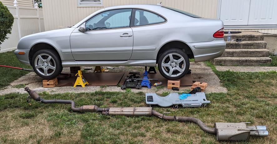

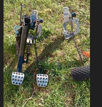

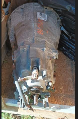

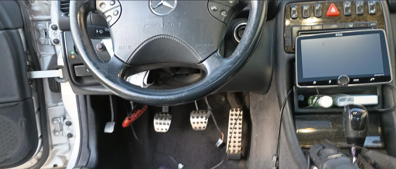

Here you go!Hello everyone, here’s the story of my C208 CLK55 6-speed Manual swap. I started it July 2023, worked weekends and got it done end August 2023. I didn’t exactly break any new ground here so let me first give props to #JikJakz and #Anderzen for being my inspiration to tackle this project on my own (with my 2 sons for some muscle when needed). I was able to get the initial coding done with my Xentry clone but couldn’t get ESP/BAS working. Drove it like that for 2 years then I reached out to the guru Josh from @ThemercedesSwapShop to get it sorted.
First order of business, auto Brake pedal out, SLK320 clutch/brake pedal ready to go in
In with the clutch pedal. I was so anxious to get this done, I installed the clutch pedal about 6 months before I started the swap! I just drove it like this with the Auto box for a few months. Never mind that hideous Radio – I will remove it eventually. I just wanted a backup camera but I’ll eventually get around to getting a better fitting head unit.
Project 6M underway – July 2023
Front half driveshaft from a 2002 S430 RWD - ~ 32”
Transmission crossmember from a 2006 C230 – still had to notch 2 holes to bolt up to my frame
Star of the show – from a 2004 Chrysler Crossfire
Shifter and clutch Master hardline from a 2003 C240
Out with 5A
Used Manual C240 Flywheel installed My bolt pattern is the original 8 evenly spaced. Bought fresh bolts referencing the 2003 C240
Luk clutch kit 081 clutch installed (reference SLK320)
In with 6M

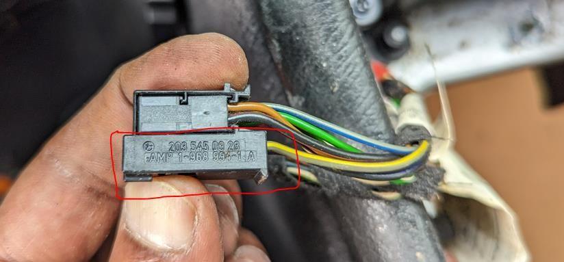

Here’s what I did to get reverse lights working. This is the connector to the auto shifter control module – the section I circled is for the reverse light switch. I just ran the 2 wires from the switch on the manual gearbox to this connector.

Now I am setting my eyes on a 2008 – 2011 CLS550 for my next swap – we shall see.
