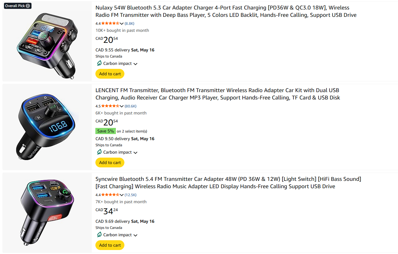

If you don't want to mess with taking your radio out and are okay with loosing your cigarette lighter there are bluetooth FM transmitters that lets you link to your phone and radio through FM radio waves. the downside is if another person is also on their radio and same frequency they can hear what you are playing very unlikely in this day and age as who listens to the radio cause everyone has adopted spotify / downloads their own music. they come with a USB port either type B or type C depending on the version you get. they can also still accept calls. there are allot of choices in styles and designs so you can pick one that fits your use case. you may need to adjust your frequency usually its on default frequency like 88.8 so you may need to change this as that may be used by a radio station. then you would find the same frequency chosen on your stock radio to listen. If your voice command works and can understand you when you say play so and so music it should work. I had one of these before i changed the radio to a sony XAV-AX4000 unit because I wanted navigation.

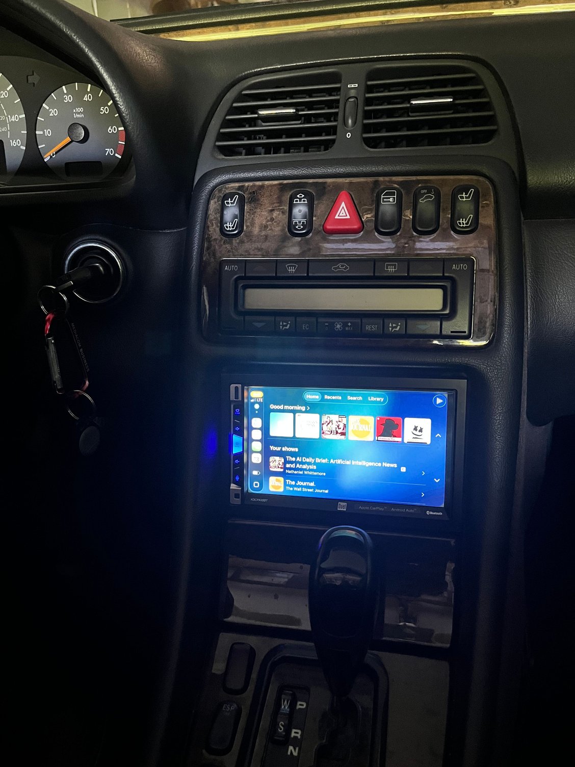

I got a double DIN from Walmart and then picked up a blue tooth dongle. It looks really nice at fits well. Cost less than $100, but I have the stock subwoofer in the back and had to wire the switch wire in the wiring harness to get that to turn on. It wasn't hard, and integrates well, just that one small thing you'll have to watch for. I have NOT gotten the steering wheel controls to integrate, but want to get that working in the future.

Here's the install fit.  Total cost was about $100 and took me maybe 2-3 hours.

Looking good!
