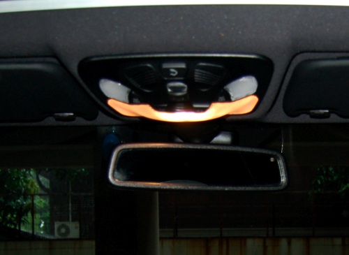

hi everybody,
i was wondering if anyone has changed the interior light color to Blue or put LED instead of that yellow light?
Could anyone help me how to take the plastic glass out and change the Bulb?
thank you

I didn't take the lights out, but I can say that you'll probably need to pop the whole overhead console assembly out. To do that, you can use an interior trim removal tool from an auto supply store, wedge it between the edge of the console and the headliner on the side opposite to the mirror, and give it a little force. There are a couple retainer clips that hold it in place, and it'll pop out easily.

Thank for ur answer, i will try to do what u said.
But does anyone have the WIS how to remove or a diagram that will help me alot.
Thank
