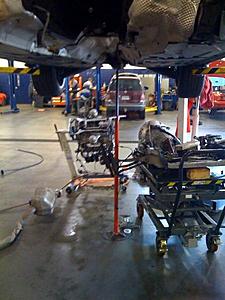

Well it's still at the dealership. I actually think the sound is normal. When I mentioned it to the shop foreman today, he said it is normal. The only reason that he has my car apart is because it was "slightly louder" than the 3 he compared it to and he wanted to make sure that there was nothing else wrong. If you listen to this youtube video, you can hear the whining noise I am talking about. http://www.youtube.com/watch?v=iPeBKnpAHaM It's the noise other than the exhaust. These cars look crazy when the engine, transmission, front steering and exhaust are removed.
I give him credit for being thorough. Also my brake pads were getting a little low. So when I mentioned it today, he said he would do it for the cost of the parts and not charge labor since he already has my car in pieces. So I am getting the brakes done for $120. That's nice of them
